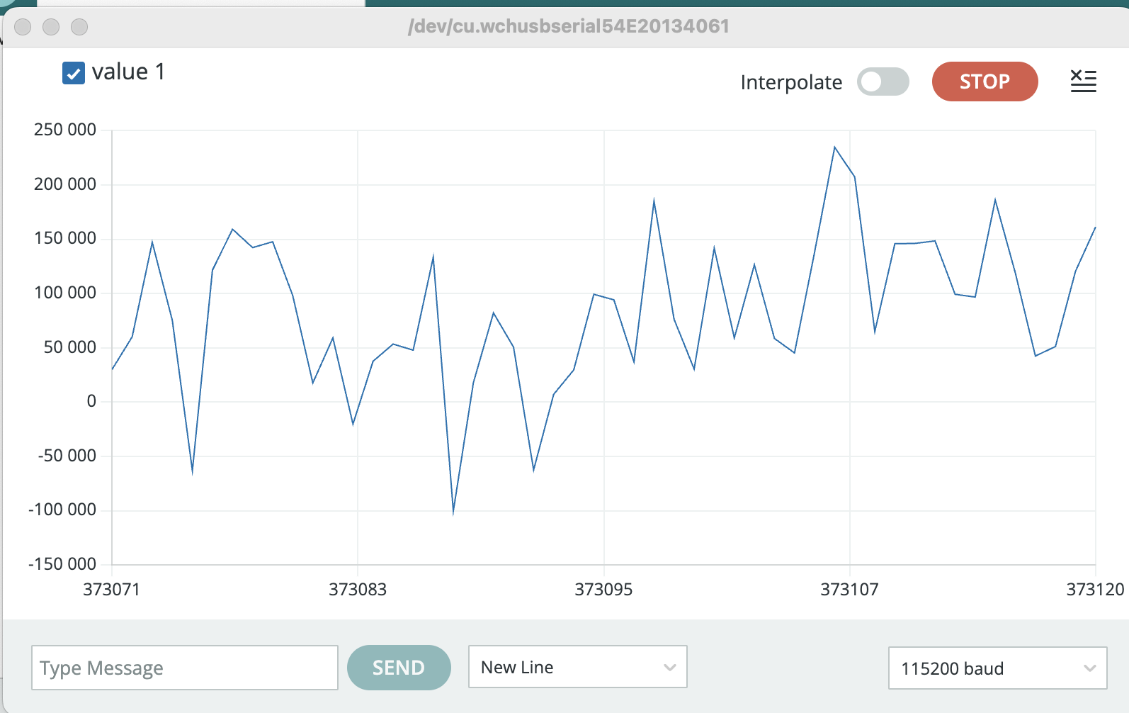

I've bought INMP441 recently and can't figured out what did i do wrong. Mic doesn't record any sound.
How can i fix this ?
INMP441 ESP32-S3-DevkitC-1
https://docs.espressif.com/projects/esp ... -1.html#j1
VDD 3v3
GND GND
L/R GND
WS 18
SCK 5
SD 17
At least i have size in file:
recording.wav 655404 bytes
Also i've tried this code:
https://github.com/atomic14/esp32-i2s-mic-test
But serial plotter is showing something strange (a lot of data every second even if the room is quiet) (SCREENSHOT ATTACHED)
My code:
