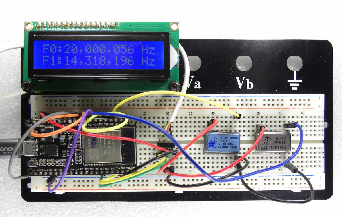

ESP32 FREQUENCY METER - 2 CHANNELS - Version 3 - Checking out
Testing my old Crystal Oscillators - 20.000 MHz and 14.318180 MHz. Very Good!
Breadboards and long wires are susceptible to noise and can interfere with measurements. The ideal is to assemble the entire circuit on a printed circuit board and use shielded cables on the frequency meter inputs. But I will wait for other new implementations to the project.
The two outputs of oscillators 0 and 1 are not being used in this test.
