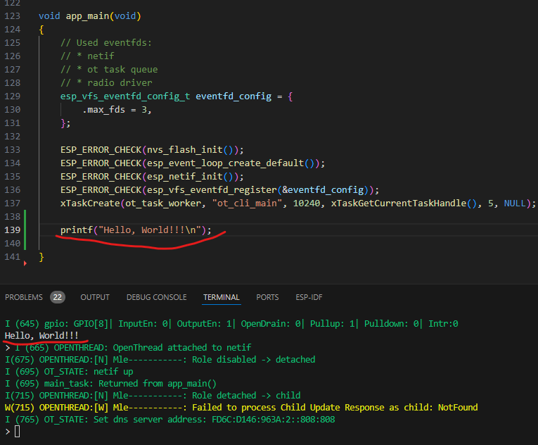

Hello everyone, I'm using vscode and ESP-IDF to develop my thread network using the OT_CLI, OT_RCP and ESP_THREAD_BR examples. So far the network is working.
Now I need to develop some code that works with the configuration made using OT_CLI on an esp32-h2. It's very different from doing something in relation to an esp32-wrom for me, who's a beginner.
Can someone help me understand how code creation works using ESP-IDF (OT_CLI)? I want to start using the thread network starting with basic things, etc. Something simple for me to understand, a code that "blinks an LED". I know it's already ready in the ot_cli menucofig, but I need to understand how to program it. I also need to know how to reference an external library. If anyone can help me with something simple, I'll be happy.
In the attached image, I put a basic printf("hello, world!!!\n") to display on the terminal in the code "esp_ot_cli.c" and it worked. However, I need to understand how external library calls work to incorporate them into the code.

Hello aliarifat794, thanks for your collaboration. I'm going to test the code and see what I can understand about how it works on the thread network and try to implement something that makes some value go to a spreadsheet in Google Sheets. It won't be easy. I did it on the ESP32WROM and it worked perfectly. But on an ESP32H2 it's going to be a challenge.

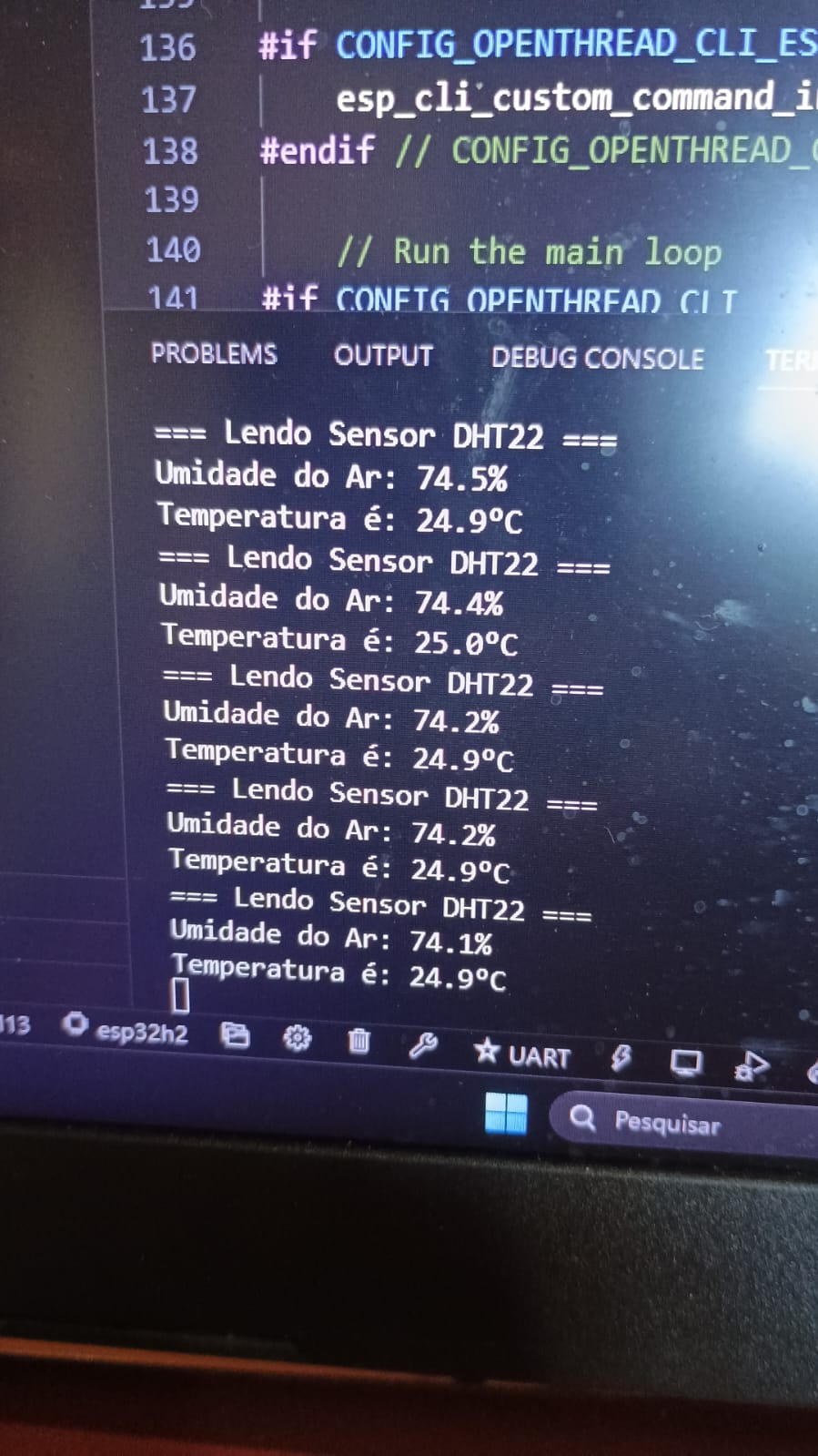

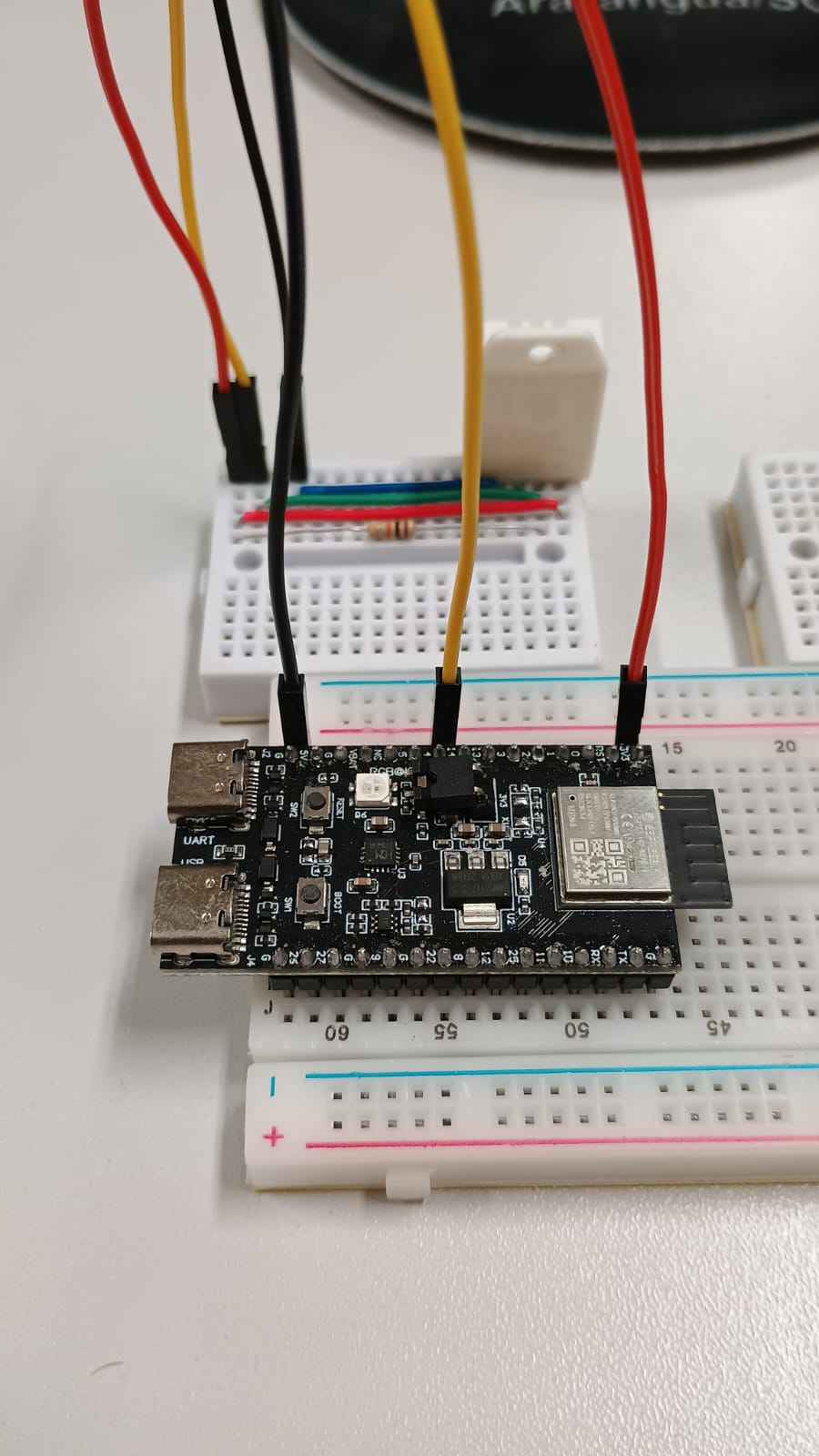

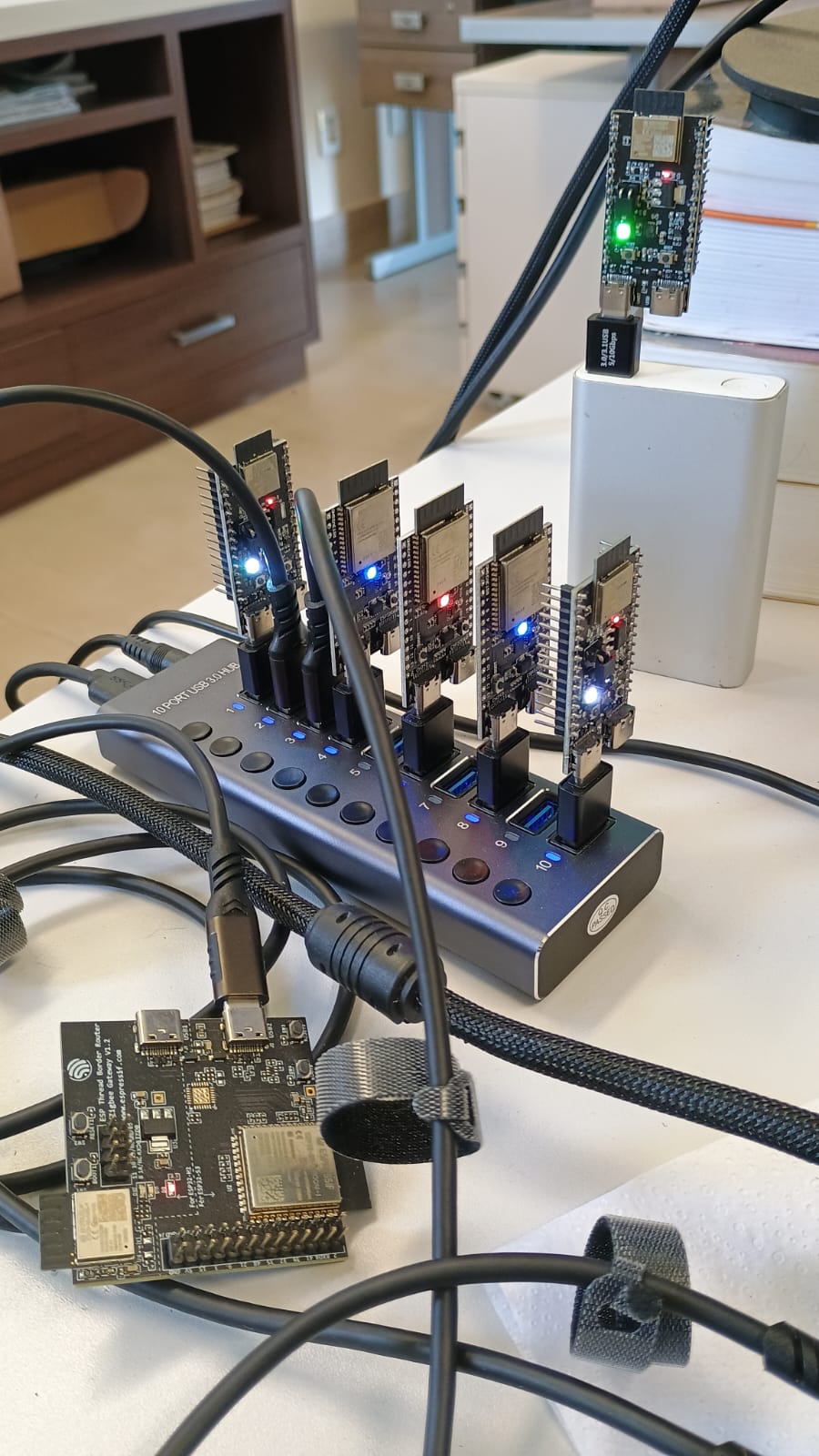

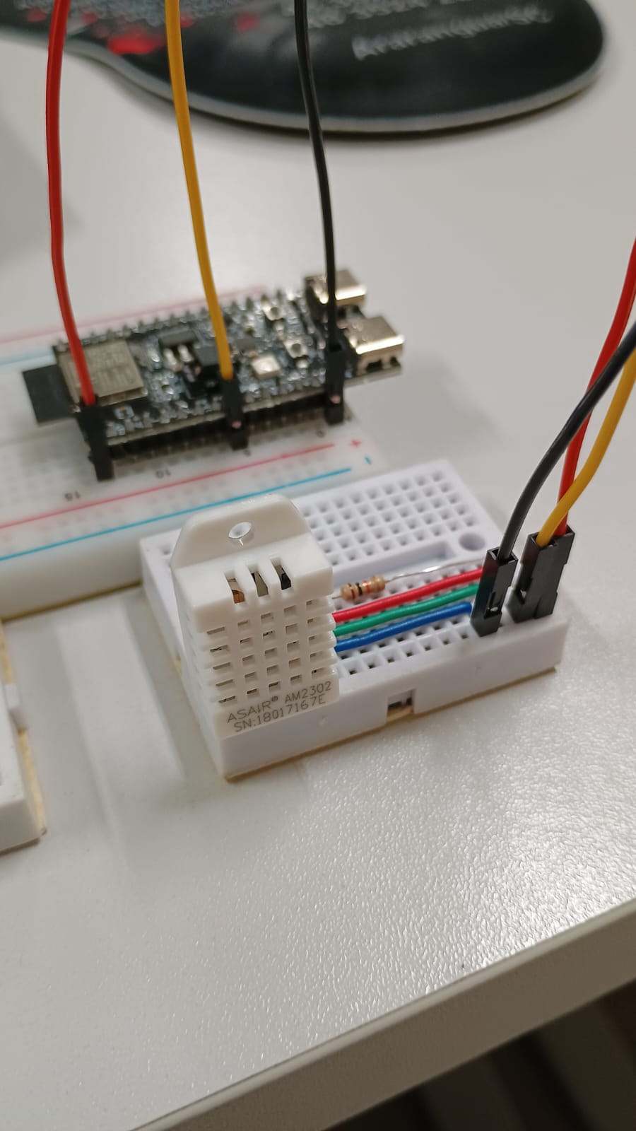

Guys, I'm here to share what I've managed to do so far with my ESP32-H2:
I started this topic asking for help to start understanding how a thread network works and implement devices. So far, everything is fine. My thread network is operational with the implemented example from Espressif. Finally, with the help of colleagues, the forum, and internet searches, I managed to adapt libraries and implement the DHT11 and DHT22 sensors. The images below show how they work. As soon as I manage to implement sending this data to a spreadsheet or database, I'll come back to update you. I hope that at the end of my project, I'll post my GitHub here with the codes and step-by-step instructions for implementation.
What I still want to implement in this small project:
- acquire date and time via NTP server;
- check the network status by simply pinging an external IP;
- send temperature and humidity data to a Google spreadsheet or database.
To give an example, I have already implemented all of this on other platforms (Arduino and esp32s3), but the challenge is to do it on a thread network as I mentioned previously.
If anyone is willing to help, I would appreciate it.
