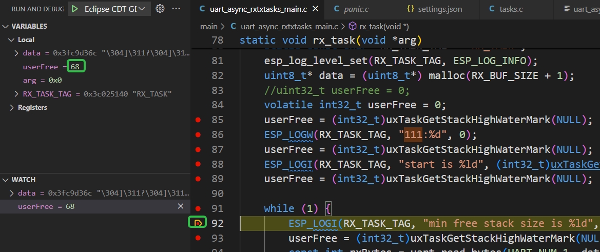

使用uart_async_rxtxtasks例程,添加打印后会出现stack overflow
june111
Joined: Tue Jan 21, 2025 9:57 am
Postby june111 » Tue Jan 21, 2025 10:19 am
硬件:ESP32-S3-WROOM-1
软件版本:V5.2.3
开发环境:VS Code
修改的代码如下
Code: Untitled.c Select all
static void rx_task(void *arg)
static const char *RX_TASK_TAG = "RX_TASK";
esp_log_level_set(RX_TASK_TAG, ESP_LOG_INFO);
uint8_t* data = (uint8_t*) malloc(RX_BUF_SIZE + 1);
//uint32_t userFree = 0;
volatile int32_t userFree = 0;
userFree = (int32_t)uxTaskGetStackHighWaterMark(NULL);
ESP_LOGW(RX_TASK_TAG, "111:%d", 0);
ESP_LOGI(RX_TASK_TAG, "start is %ld", (int32_t)uxTaskGetStackHighWaterMark(NULL));
while (1) {
ESP_LOGI(RX_TASK_TAG, "min free stack size is %ld", (int32_t)uxTaskGetStackHighWaterMark(NULL));
const int rxBytes = uart_read_bytes(UART_NUM_1, data, RX_BUF_SIZE, 1000 / portTICK_PERIOD_MS);
if (rxBytes > 0) {
data[rxBytes] = 0;
//userFree = uxTaskGetStackHighWaterMark(NULL);
ESP_LOGI(RX_TASK_TAG, "Read %d bytes: '%s'", rxBytes, data);
ESP_LOG_BUFFER_HEXDUMP(RX_TASK_TAG, data, rxBytes, ESP_LOG_INFO);
ESP_LOGW(RX_TASK_TAG, "error:%d", 0);
free(data);
异常日志如下:

疑问:
1、ESP_LOGW函数调用之后没有释放栈内存?
调用了一次ESP_LOGW(RX_TASK_TAG, "111:%d", 0);之后,后继查看uxTaskGetStackHighWaterMark(NULL)没有变回原来的大小。
2、是否不应该使用uxTaskGetStackHighWaterMark查看,但没有找到获取当前线程剩余栈空间大小的函数接口
调试过程请查看附件
