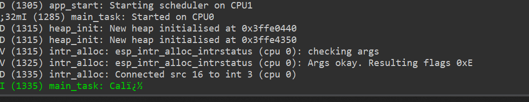

Hi all, I assume I'm doing something stupid but I can't figure it out at the minute. Using Espressif-IDE, DOIT Devkit v1 ESP32. Whilst my program runs absolutely fine I can't get any printf output to the terminal - I get all the flash and boot information but then it stops at the green line below - could someone put me out of my misery please? Thanks.

To add some more information:
- I've confirmed the monitor is at 115200
- I've tried different usb ports and cables (all flash fine, all give no serial output)
- I've tried manually resetting the board with the terminal running

It's this block of code below that's causing the problem, but I don't know why. Switched to VS Code to ensure there was no environment issue going on that I couldn't find.
/*gpio_config_t io_conf1;
				io_conf1.intr_type = GPIO_INTR_DISABLE;//disable interrupt
				io_conf1.mode = GPIO_MODE_INPUT;
				io_conf1.pin_bit_mask = (1ULL<<1);//bit mask of the pins that you want to set,e.g. GPIO 1
				io_conf1.pull_down_en = GPIO_PULLDOWN_ENABLE;//enable pull-down mode
				io_conf1.pull_up_en = GPIO_PULLUP_DISABLE;//disable pull-up mode
				esp_err_t error1=gpio_config(&io_conf1);//configure GPIO with the given settings
				if(error1!=ESP_OK){
					printf("error configuring GPIO1 \n");
			   #define BUTTON_RED_DOG1 GPIO_NUM_1 */
This is run at the start of app_main. Similar blocks exist for numerous other pins but seem to cause no issue.
GPIO1 is UART0 TX, so if you use it for another purpose, standard output will no longer be output.

Perfect, thanks!
