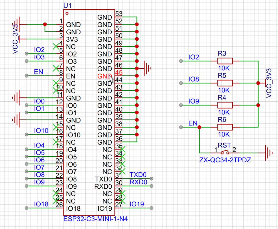

Postby troymitchell » Sun Dec 01, 2024 8:52 am
As the title says, I designed a circuit board, soldered the necessary components (ESP32, LDO, USB), and found that /dev/ttyACM0 can be recognized but cannot perform any operations. Can anyone help me?

Postby Sprite » Mon Dec 02, 2024 4:48 am
For the first flash, you may need to either have luck with timing or lower GPIO0 while resetting the module. Without valid flash, the ESP32C3 will enter a bootloop which can make it hard to get the flash timing right; booting with GPIO0 forces download mode which bypasses this.

Postby troymitchell » Mon Dec 02, 2024 6:11 am
This is so weird. When I used the ESP32-C3-FN4 chip, everything was fine for the first flash.
This time, due to the problem of the workplace, there is no good welding equipment, so I chose the module, but I was disappointed that I had to take my chances for the first download.
finally,
I held down the reset button, and then let go of it at the moment of downloading, and everything was fine. Thank you very much for giving me ideas.
