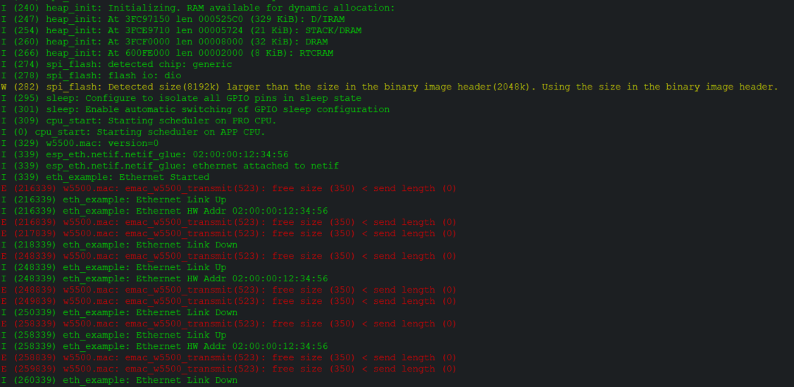

Hi, I have been trying to run the Ethernet Basic example (https://github.com/espressif/esp-idf/tr ... rnet/basic) on my ESP32S3-WROOM-1 devkit connected through SPI to a W5500-EVB board (https://www.digikey.com/en/products/det ... VB/8789607) and have been unable to have the example successfully work. The program begins infinitely looping once the "Ethernet Started" message is outputted to the terminal. Then at seemingly random intervals, error messages are outputted to the terminal before once more looping.

Terminal output:
Screenshot 2023-07-07 163202 1.png (172.8 KiB) Viewed 5135 times
Any help would be greatly appreciated, thanks!

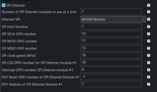

Here is a screenshot of my sdkconfig file > Example Configuration:
Screenshot 2023-07-13 135027.png (57.86 KiB) Viewed 4875 times
Please let me know if there are any other potential causes of this error and/or fixes, thanks.
ondrej
Posts: 227
Joined: Fri May 07, 2021 10:35 am
Re: ESP-IDF Ethernet Basic Example not working with ESP32S3 and W5500-EVB
Postby ondrej » Fri Jul 14, 2023 8:01 am
I see that you've mentioned the CS is pulled low on the board. However, would it be possible to connect CS to the GPIO? I have this type https://www.amazon.de/-/en/TECNOIOT-USR ... B07RGLN436 of W5500 module and when I connect the CS to GND it does not work.... It theoretically should but it doesn't and I haven't had time to investigate why.
