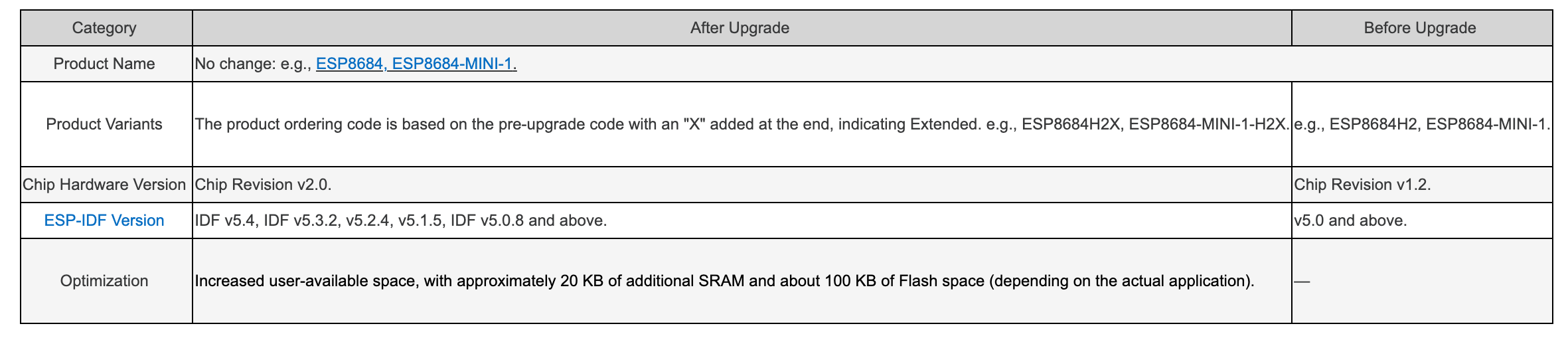

Product Upgrade Comparison: Before and After
Product Upgrade Comparison.png (135.53 KiB) Viewed 25070 times
