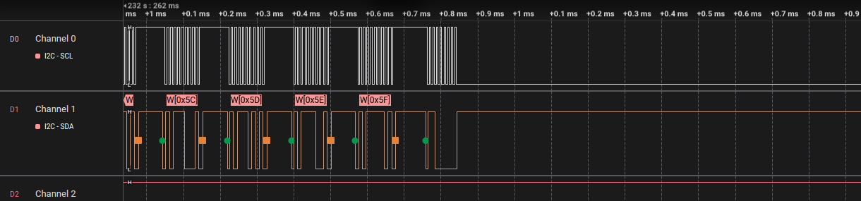

Problem Statement:-
Sometimes, a slave gets stuck on the I2C line.
The slave holds the I2C line low, causing clock stretching.
The master becomes unable to communicate, even after being reset using a dedicated reset button.
I have a screenshot from a logic analyzer showing that my first slave successfully commissioned and received the address 0x60(slave address). However, when I add a second slave(second slave address 0x01), the first slave starts holding the SCL line low. It reaches the 0x5F address, then 0x60, so I think the slave is holding the SCL line.
Currently , the code is only working when we reset that particular stucked slave controller which is not at all efficient solution.

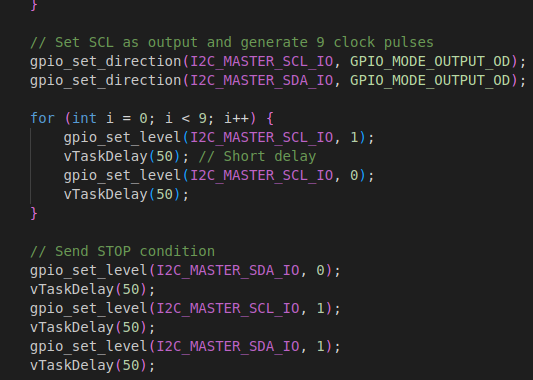

A method to unbrick the I2C line by reinitializing I2C on the master side.
Alternative solutions to recover a stuck I2C line without requiring a hardware reset or power cycling.

i tried this clock recovery snippet
Screenshot from 2025-03-06 15-41-54.png (62.02 KiB) Viewed 832 times

What chips do you use as slaves?
In general, I'm not sure if there's a way to get out of that situation if you only control the master. With the SCL line stuck low, there is no way the master can generate a start or stop condition or send any data.

The slave controller is STM32G031K8 from STM . The first slave is working just fine with the master , but when second slave is plugged the first slave is pulling the SCL line low and is not releasing it even on resetting the master controller . Only after resetting the first slave , the SCL line is released , but this is not at all an efficient solution .

Sounds like you're better off searching for a solution on the STM32G031K8 side of things, then.
