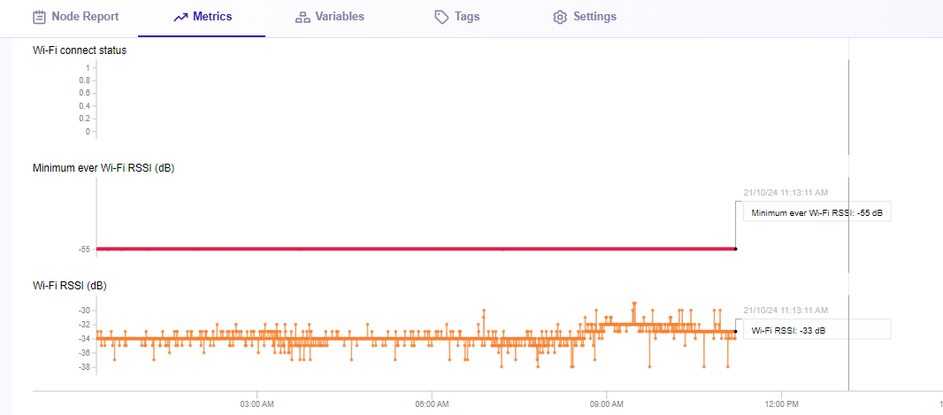

It suddenly stopped again. I just noticed it this morning and looking into Insights it shows it suddenly just stopped yesterday:

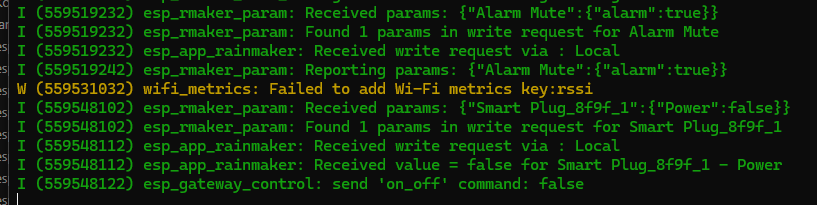

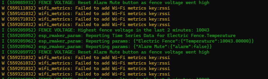

In esp_idf it jsut shows that wifi metrics failed to add, also the parameters aren't being sent either, however the esp_rmaker_param_update_and_report doesn't seem to throw an error.

The node is still connected to Rainmaker because I can still send control messages and they are received successfully.
Screenshot 2024-10-22 093312.png (43.26 KiB) Viewed 21241 times
Any idea what might be causing this?
