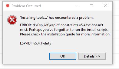

How to Re-install Espressif IDE with Eclipse on win10? It seems I installed twice . After removing , can not add new framework properly.
What need to do to clean system ?

I see you’ve posted this question in the ESP-IDF Installation Manager thread. Are you using EIM? If yes, please note that EIM is not yet supported in the IDE.
When you say "cannot add new framework properly," do you mean that you’re unable to install ESP-IDF? Could you please describe the problem you’re experiencing in more detail and share the logs to help us assist you further?
To install ESP-IDF and its tools within the IDE, please follow the instructions here: https://docs.espressif.com/projects/esp ... stallation
For cleanup in the IDE, it’s better to start with a new workspace and import your project. There’s no need to uninstall all tools and ESP-IDF; instead, select ESP-IDF using this approach: https://docs.espressif.com/projects/esp ... stallation
If you still have the problem, please report your issue directly here - https://github.com/espressif/idf-eclipse-plugin/issues
I hope that helps!

I can not add framework. I tried to uninstall and install a few times but the same mistakes all the time. I used standard Setup of Toolchain for Windows. It seems that one of installing scripts works in the bad way

Looks like the something went wrong. I would suggest you to follow the below procedure.
1. Delete your existing installation folder
2. Download Espressif-IDE windows offline installer here- https://dl.espressif.com/dl/idf-install ... -5.3.1.exe
3. Follow the installation instructions from here - https://docs.espressif.com/projects/esp ... einstaller
4.Launch Espressif-IDE
