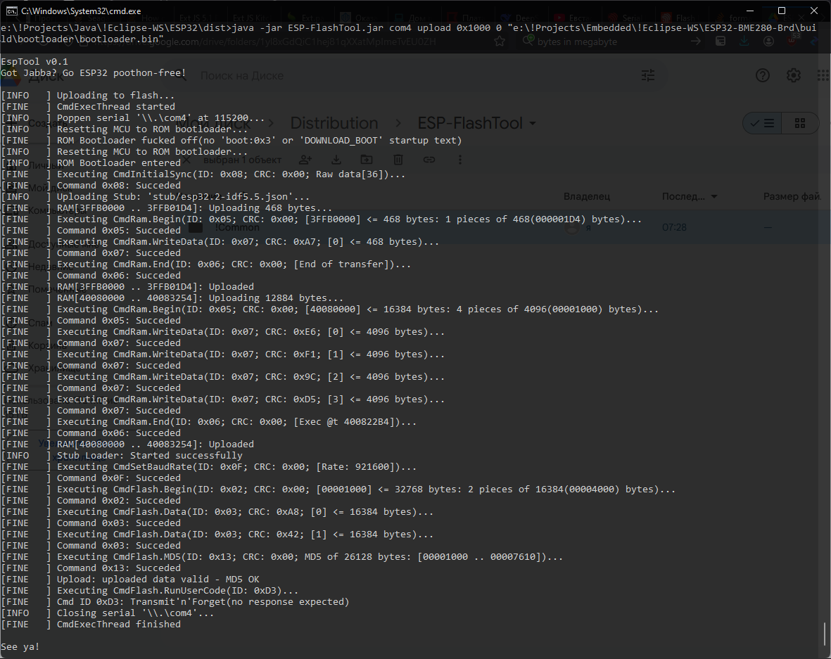

picking all this poothon stuff generously stuffed to us by the ESP team, i come to the conclusion that this is, definitely, possible.
let me present a proof-of-concept build of Java (+ a native library "jSerialComm") Esp32 FlashTool, capable of basic ESP32 serial operations:
running: java -jar ESP-FlashTool.jar ...
Requres JDK 21+
no poothons
Reading MCU ID + MAC + some EFUSEs:
Flashing user bootloader:
- read MCU ID + EFUSE bank 0
- upload and run ESP-IDF ESP32 Stub loader from json file
- retrieve MD5 of a specified flash region
- dump specified flash region to binary file(at 921600)
- upload (specified part of) binary file to specified flash region(at 921600)
- erase specified flash region
- erase flash completely
Requres JDK 21+
no poothons
Requres JDK 21+
with capability of flashing (part of) binary file at specified address it's easy to go further - enable flashing of a whole ESP project at once: ALL binaries, mentioned in 'flasher_args.json' at their correct offsets.
so, totally no need in poothon to flash ESP32 - just say:
> java -jar ESP-FlashTool.jar COM1 upload "path\to\flasher_args.json"
ESP-FlashTool.jar
