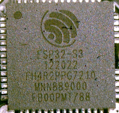

Attached is the device we are using. Anyone got any ideas on what could cause this and a workaround?

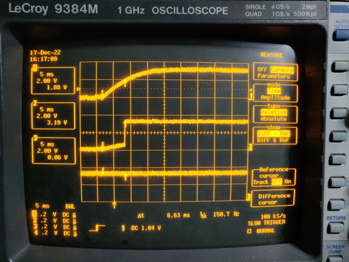

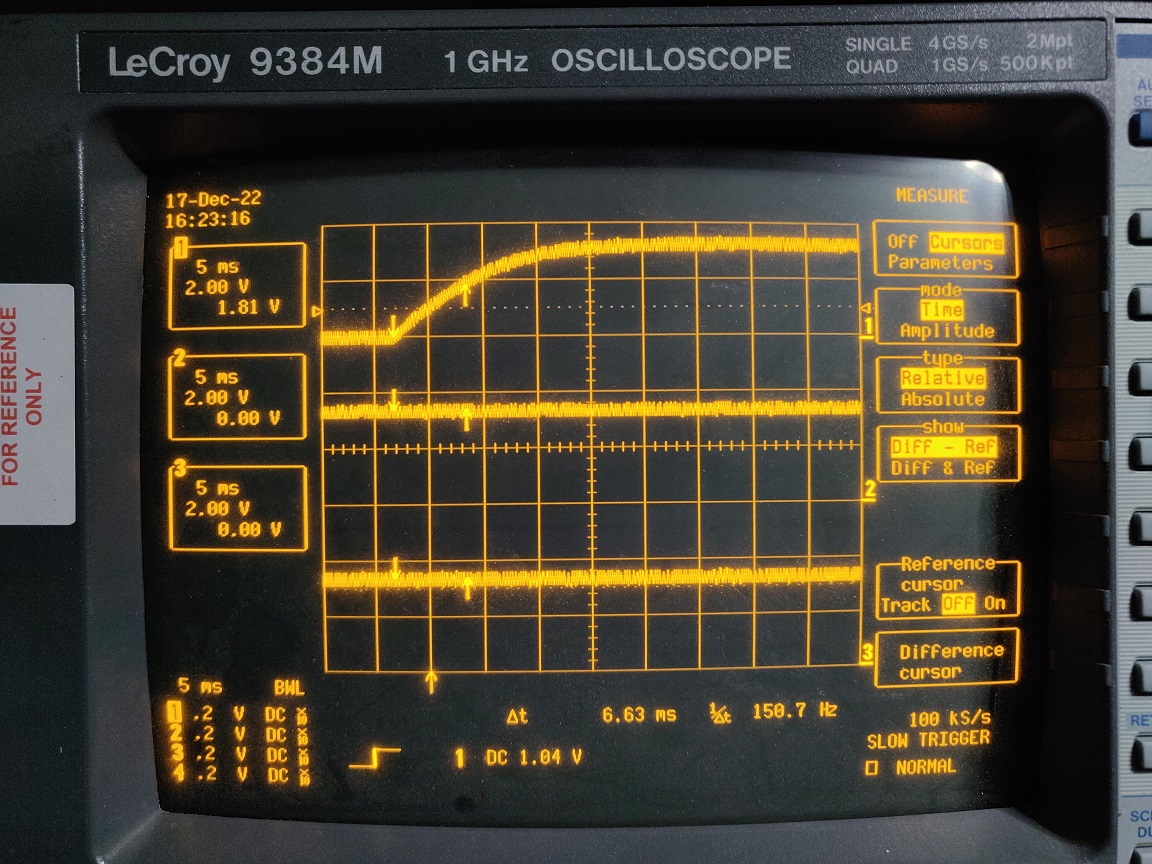

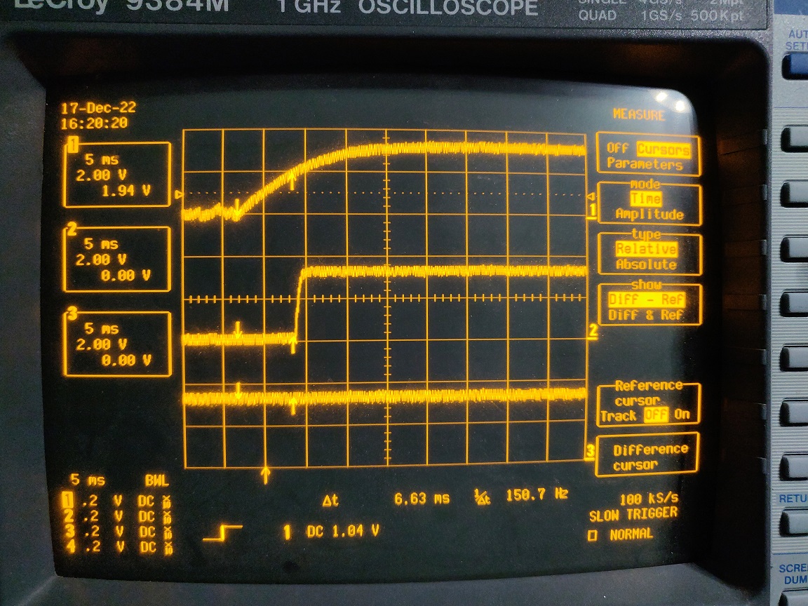

I put a scope on the 3.3V Power, CPU_PU (EN), and GPIO0. The problem was with GPIO0. I was relying on the internal weak pullup on this line but I didn't realize that the internal pullup was only active after the CPU came out of reset. Any delays from capacitive loading (in my case 0.01uF switch debouncing) are with respect to the CPU coming out of reset, not with respect to powerup. In my case there is about a 5ms reset from the standard RC circuit.
Attached are the scope plots. In all plots the top trace is CPU_PU, the second trace is GPIO0 and the bottom trace is the 3.3V power.
Plot 4: Power up with GPIO0 No connection. (Correct startup)
Plot 5: Power up with GPIO0 0.01uF to Gnd. (Started in Boot Loader Mode)
Plot 6: Power up with GPIO0 external 10k pullup. (Correct startup)
In may case (plot 5) the additional delay after reset when the internal pullup becomes active was enough to make the timing marginal. I think I'll play it safe with a 10k external pullup so that GPIO0 is 1 from power up. Problem solved.
