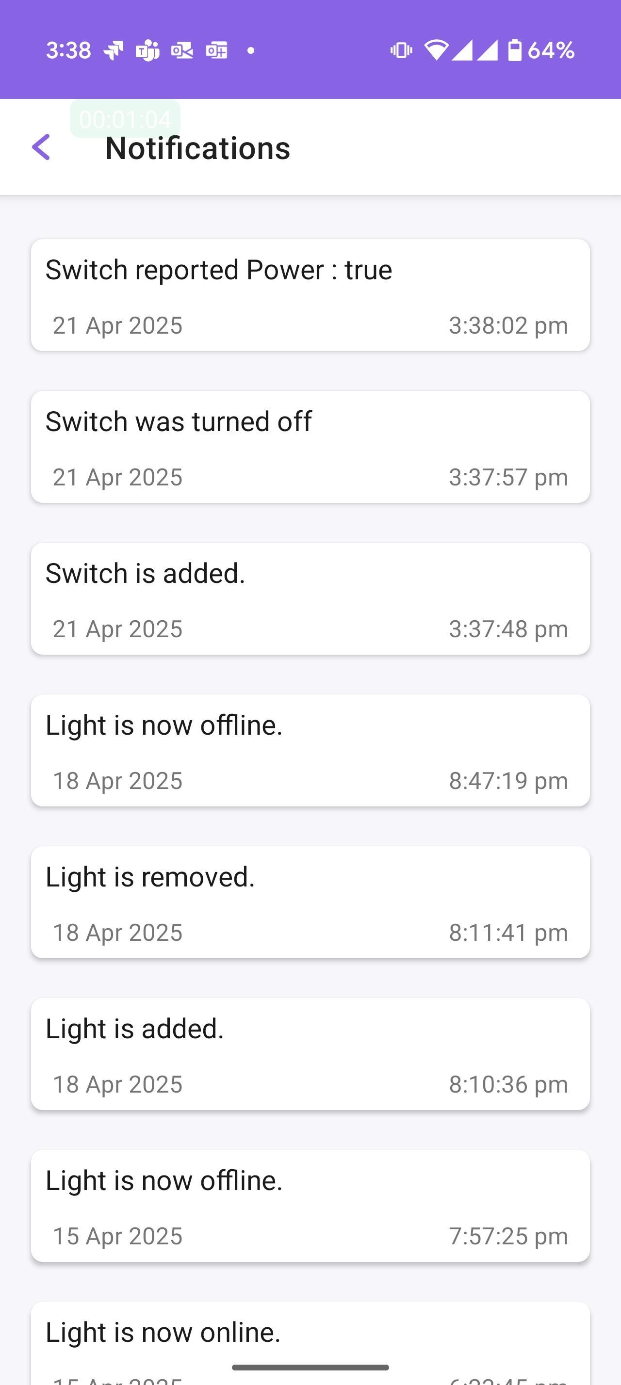

The devices are now online and more stable after continuously going ONLINE and OFFLINE for more than an hour during the scheduled Maintenance, but now I have another issue that is I noticed that the alerts on iPhone are not displaying the actual custom messages sent using esp_rmaker_raise_alert("Front Door Opened"); in the Arduino code.
Instead, the iPhone only shows a generic message: "Alert received from a device", and the detailed text is missing. Additionally, these notifications are not appearing in the app’s notification history under Settings > Notifications.
This reduces the usefulness of alerts, as the actual context of the message is not visible.
Could you please help us resolve this issue?

I tested node alert notifications with the switch example, with CONFIG_EXAMPLE_ENABLE_TEST_NOTIFICATIONS set, which then alternates between using esp_rmaker_raise_alert() and esp_rmaker_param_update_and_notify() as you keep toggling the switch using BOOT button. On both, iOS and Android, the notifications were received and displayed correctly.
Media (15).jpeg (151.65 KiB) Viewed 8966 times
I have not tried with Arduino, but it is expected to be similar.

The delay and node allocation started to work as before since Saturday, so I suppose it was a temporary issue. I have used the same software/baseline, so nothing was changed in the code. Now, there are no delays or node allocation issues anymore.
The only issue that remains is regarding the alerts. I have observed that only using "\n" (new line) in the alert text caused this "Alert received from a device". Without new lines, I don't see a limitation in the size of the alert.
Previously, when there were no "Push notifications with sound" on IOS, I could send alerts that contained new lines and receive the notification properly formatted on my iPhone (with no default notification sound indeed). After the 3.1.0 update (03-Apr-2025), the sound was added to the notification, but also this limitation as well.
The Node ID is 10003BFBC214. The alert is triggered via esp_rmaker_raise_alert, and I don't see any error in the console logs.

Hi @Dorian ,
Thank you for the detailed update.
Based on your observation and the reported error, it appears that the issue with the alerts was caused by the presence of unescaped newline characters (\n) in the alert string. On iOS, such unescaped control characters can lead to JSON parsing failures, which explains why the alert was not handled correctly.
To resolve this, you can modify your alert message by escaping the newline character using a double backslash (\\n). For example:
esp_rmaker_raise_alert("Switch was turned off.\\nPlease check.")
This ensures that the JSON payload remains valid and is parsed correctly by iOS.
Let us know if you observe any further issues.

Awesome, this solves all the issues, now everything is working perfectly.
Many thanks @vikas.chandra
