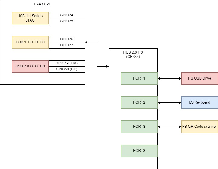

Hi guys,
I try to use tinyusb as host with the P4. I don't use the espressif host lib because it do not support hub with different speed class device (it's not possible to connect an usb keyboard LS ans usbkey FS through a FS Hub)
So my question : is someone know where I can find an example of tinyusb host with esp32 please ? I tried to run stock tinyusb exemple but I didn't managed to complie.
I added espressif/tinyusb: ^0.18.0~2 to my idf_components.yml but i didn't find the bsp code for my target. In the exemple provided, it failed at the first line : #include "bsp/board_api.h" because the build system didn't find it.

As far as I know in tynyusb there is no support for espressif chips USB host mode, but I may be wrong.
In terms of low and high speed in usb hub, I can tell it's hardware limitation and P4 just can't support it.

Hi @robin2906,
P4 has two peripherals, one is 2.0 (High-speed) and another one is 1.1 (Full-speed).
There are couple of things, that currently in progress, otherwise:
- High-speed peripheral has a hardware limitation, when implementing Transaction Translator (needs for Full- and Low-speed devices, connected via High-speed hub) is not possible. So, there will be no support for such thing in the current version of P4 chip.
- Full-speed peripheral doesn't have such limitation and both Full- and Low-speed devices could be connected via external Hub. Selection of the peripheral upon USB Host Library installation is almost done and soon will be available.

I was not fully correct here: has a software limitation.
In espressif, we are using the Scatter-Gather DMA mode in the host driver. And in this mode split-transactions are not supported. And there are no plans to move to other mode ATM.
They are supported in two other modes: Slave (when the application initiates the data transfers for data fetch and store ) or Buffer DMA.
So, it is possible to attach Low-speed and Full-speed devices via external hubs to P4 USB High-speed peripheral, for example, with tinyUSB host stack.

Thank you very very much for your answer, so if I understand correctly we can summarize the status like this :
This can work with TinyUSB as host stack, but will not work with Espressif Host stack (due to lack of STT support)
This will work with both host stack ( Espressif Host stack and Tiny USB ) when espressif stack support the settings of which OTG host ( FS or HS) is used by the stack :
But the USB drive will use FS speed not HS, correct ?

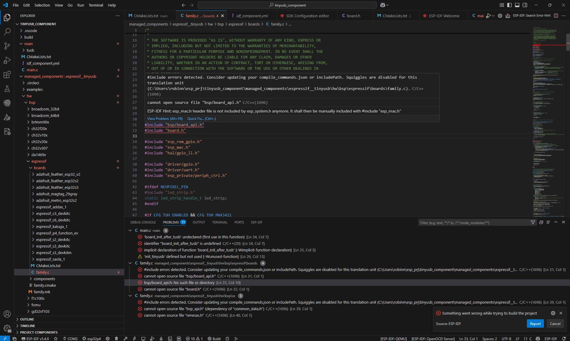

I keep digging with TinyUSB, I made some progress but now i'm stuck...
I am able to compile the TinyUSB component from espressif and I can include #include "tusb.h" in my main :D
But I am unable to include #include "bsp/board_api.h" in my main and iam not able to compile familiy.c because of #include "bsp/board_api.h" not found
My CMakeLists.txt next to my main.c is like this :

This gave me :
So what is the proper way to compile the tinyusb bsp for the P4 ?

Yes, you can attach external hub to both peripheral, but when you attach it to the Full-speed peripheral, the High-speed hub and any other High-speed downstream device will be Full-speed.
So yes, this is correct. If the device supports USB 1.1.
Also, keep in mind that USB 1.1 perihipheral has only 8 channels, which means that you are able to keep 8 open endpoints.
External Hub uses 2 channels (one for CTRL and one for IN), so there is only 6 channels left. This might be not enough to support the Drive (usually 3 channels required), Keyboard (usually 2-3) and QR scanner.
I would suggest to try the tinyUSB example directly from the upstream branch to test your board, if you have a proprietary one.
The description how to build it you may find here: https://docs.tinyusb.org/en/latest/refe ... arted.html
Indeed, you need to build the example under the esp-idf, so you need to install it in advance: "install.sh" and then "export.sh" (or another commands, according to the way and OS where you are doing it).
After building the example, you may create you own application with using espressif tinyusb component, but for the usb host application you have to provide "tusb_config.h" with all parameters.
There is another approach to solve this:
To enable USB peripheral, you need to enable PHY. You can do it without any files from tinyusb, but implement you own function, which does that.
For this you will need only "usb_phy.h" from the "idf/component/usb/include/esp_private".
Just the same way as in here: https://github.com/hathach/tinyusb/blob ... ily.c#L164
