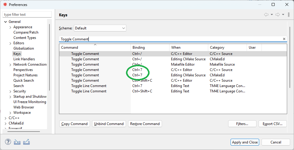

1. Go Window -> Preferences -> General -> Keys
2. type Comment in the search bar.
3. Find Toggle Line Comment, Ctrl+7
4. Copy that Command
5. In the new command add Ctrl+/ and press Apply
6. If you have numpad - copy again and add Ctrl+Numpad_Divide shortcut and press Apply
7.Profit

Postby justinmreina » Sun May 18, 2025 2:18 pm
Excellent @ohmycat, I had no idea! This was a simple solution and I appreciate the detail you share 😎
Here was the fix I used, see attached -
Example 'Toggle Comments' setting
