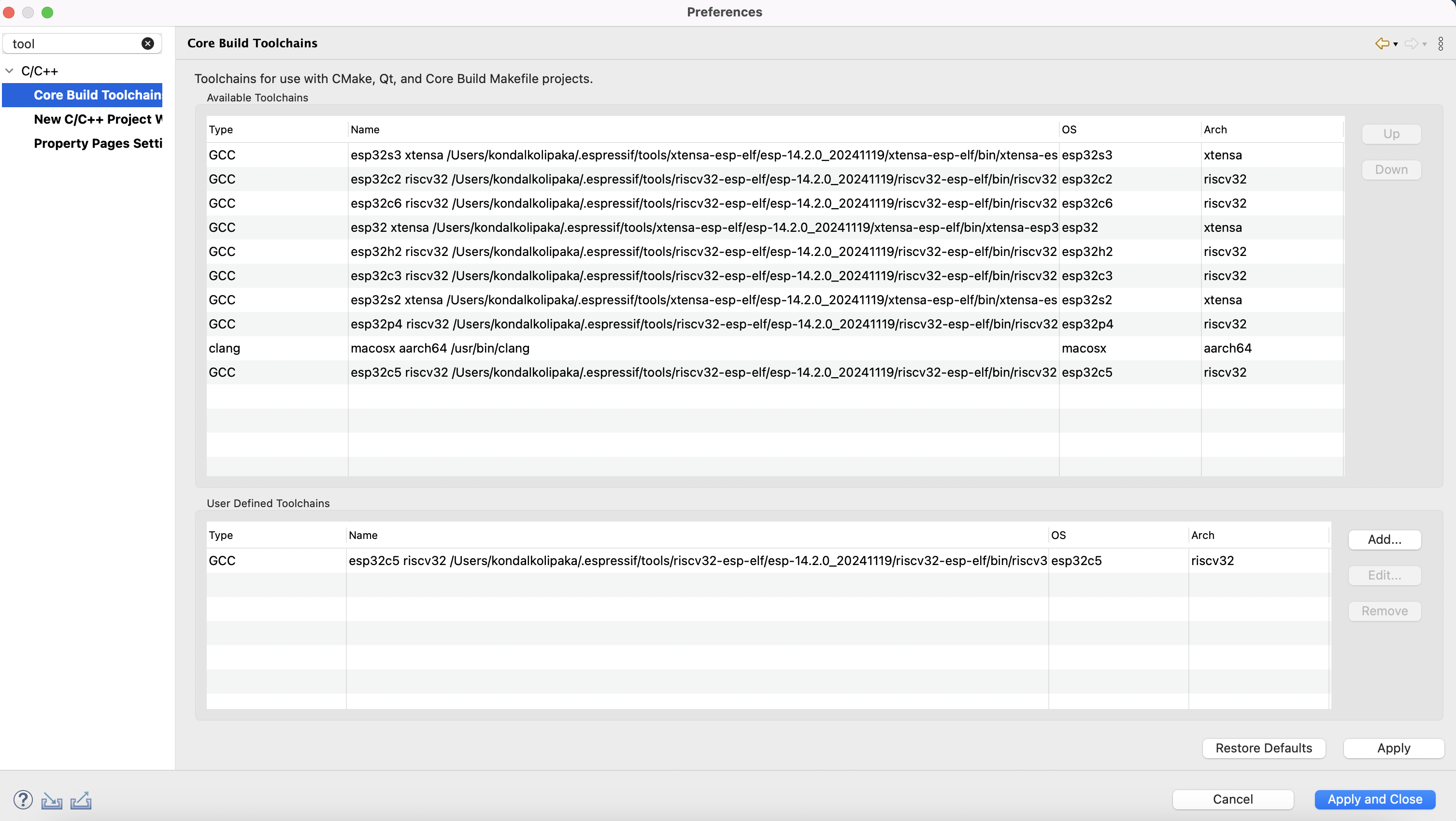

Step 1: Configure Toolchain
1. Go to Preferences → C/C++ → Core Build Toolchain.
2. Under User Defined Toolchain, click on Add….
3. Select GCC and configure as follows:
• Compiler:
/Users/testuser/.espressif/tools/riscv32-esp-elf/esp-14.2.0_20241119/riscv32-esp-elf/bin/riscv32-esp-elf-gcc
• Operating System: esp32c5
• CPU Arch: riscv32
4. Click Finish.

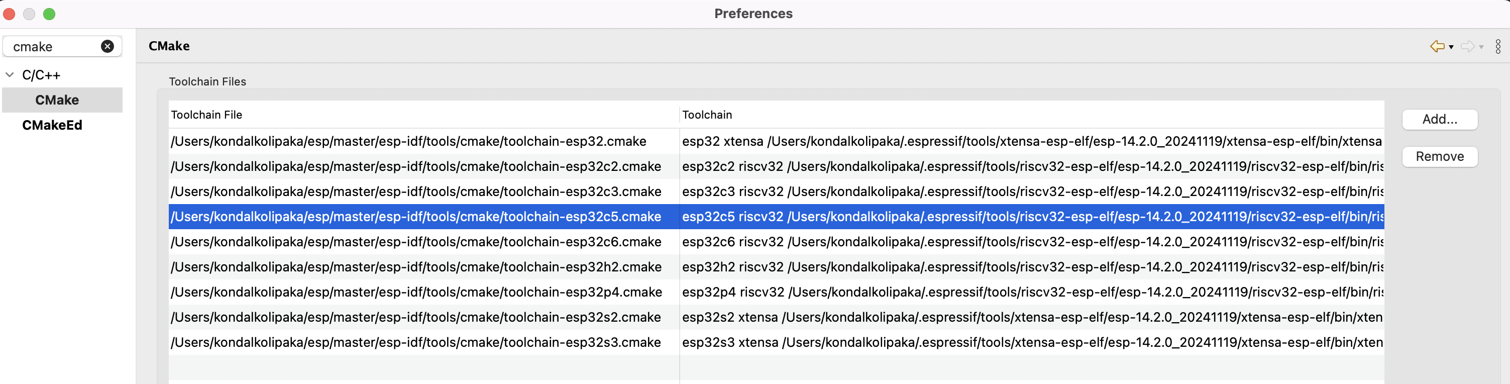

Step 2: Configure CMake Toolchain
1. Navigate to Preferences → C/C++ → CMake.
2. Click on Add….
3. Browse and select the ESP32-C5 CMake toolchain file:
/Users/testuser/esp/master/esp-idf/tools/cmake/toolchain-esp32c5.cmake
4. Choose the corresponding toolchain entry created in Step 1.
5. Click Finish.

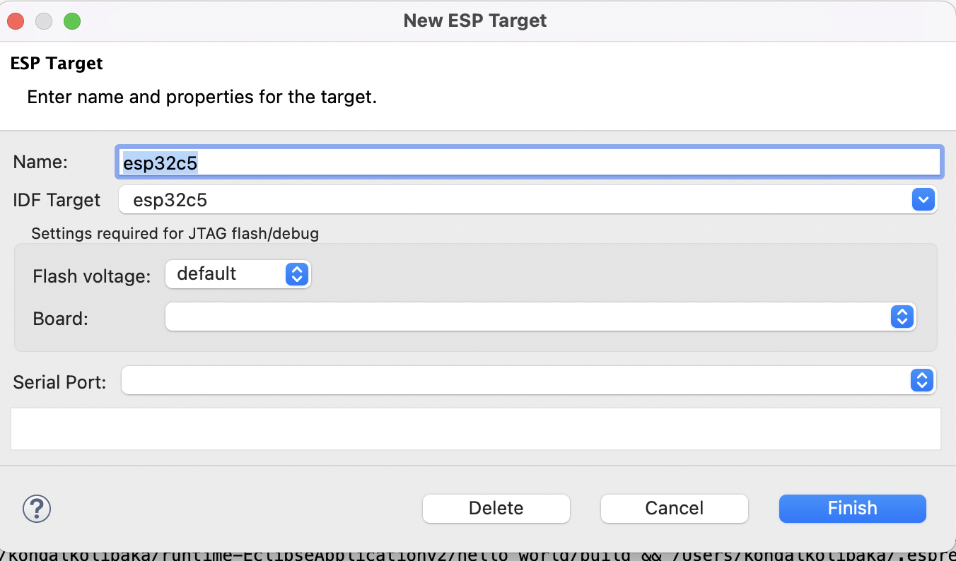

Step 3: Add ESP32-C5 Launch Target
1. From the IDE’s top toolbar target list, click on New Launch Target.
2. Select ESP Target.
3. Provide the following details:
• Name: esp32c5
• IDF Target: esp32c5 (you can edit or reuse an existing entry)
4. Click Finish.

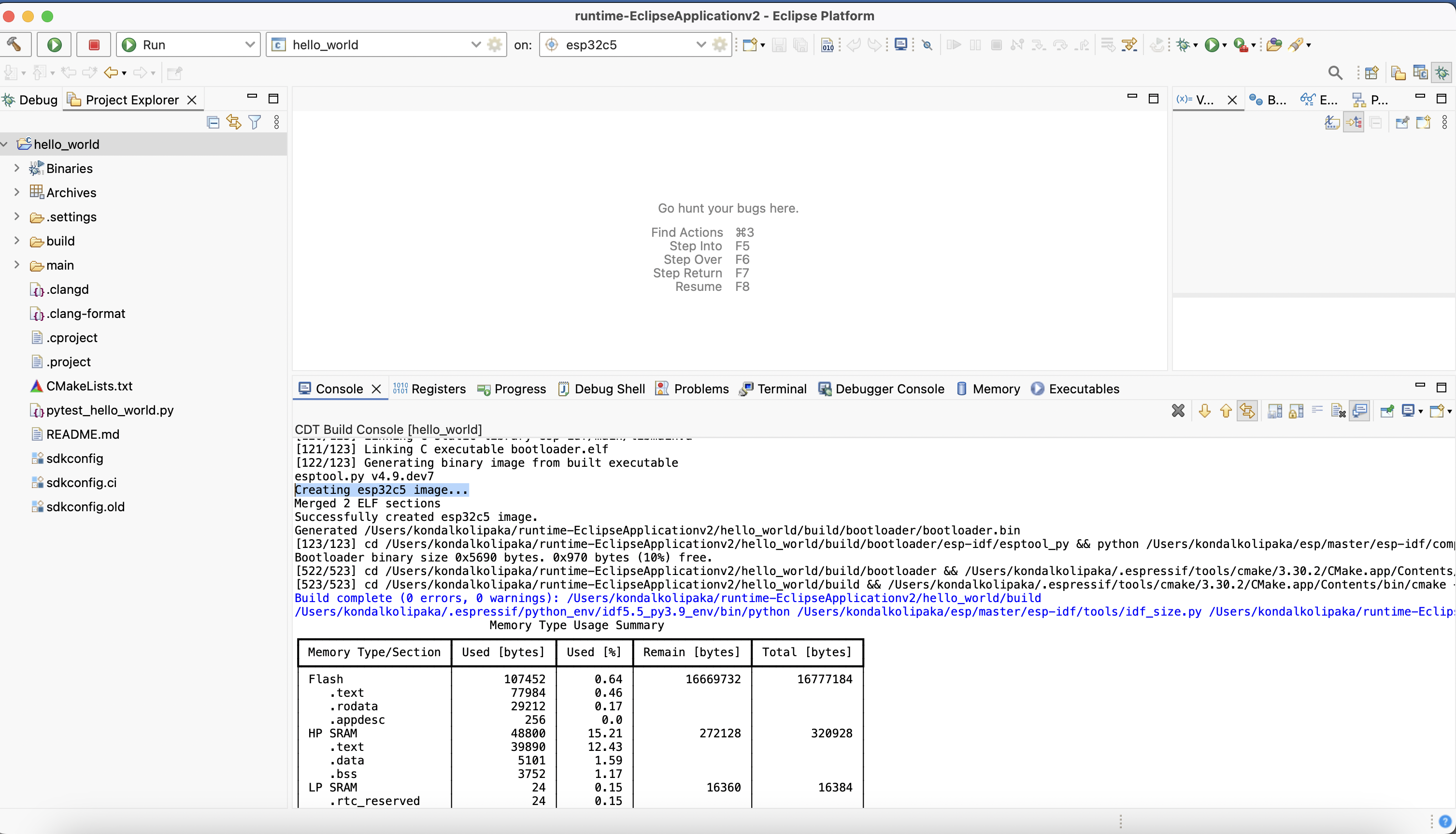

Attaching the screenshots for reference for building with the esp32c5 with the espressif-ide v3.4.0

thank you kondalkolipaka, I followed your instructions and successfully compiled the hello world example code for the esp32c5 target.
and I will try flashing and debugging later on.
