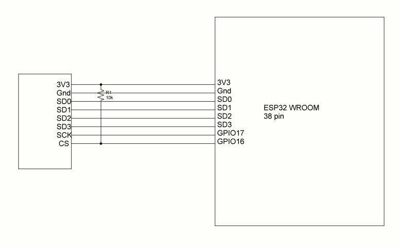

I have connected an ESP PSRAM64H chip to an ESP32 WROOM board (38 pin, with SPI1 pins exposed (GPIO6, 7, 8, 9, 10)) following the same pin connections as for ESP32 WROVER B, as shown in the schematic below:

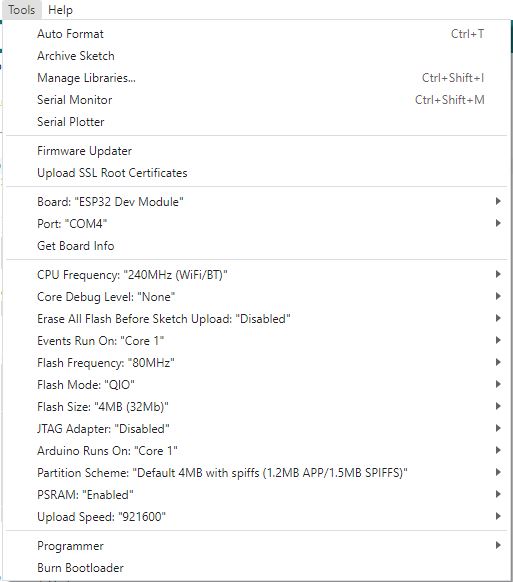

I have setup the board parameters to ensure PSRAM is selected as enabled:

Yes, there seems to be activity (oscilloscope) on the pins, and I have used a multimeter to check the connections between the pads on the ESP32 WROOM module that correspond to the pins on the dev board, and they are all continuous and connected to the correct pads/pins.
I'm wondering if just assuming that GPIO16 and GPIO17 are the correct pins for CS and SCK, respectively, is correct? These seem to be the pins used by ESP32 WROVER, but maybe these pins need to explicitly setup somewhere when used on an ESP32 WROOM board?
I note that GPIO6 is labeled "SCK" (presumably for SPIO1) in some pinout diagrams, and I wonder why this clock line is not used with external PSRAM, instead of GPIO17?

Hm, weird then... how did you connect the psram btw? It gets ran at pretty high speeds, so if you use e.g. a breadboard setup, that may not work because of signal integrity issues. (Although I'd imagine that may also affect the flash in that case.)
It's correct. SCK is a separate IO pin because PSRAM has a slightly different clock requirement than the flash, and the ESP32 hardware wasn't designed to incorporate that yet, so we use a different peripheral to generate the clock.

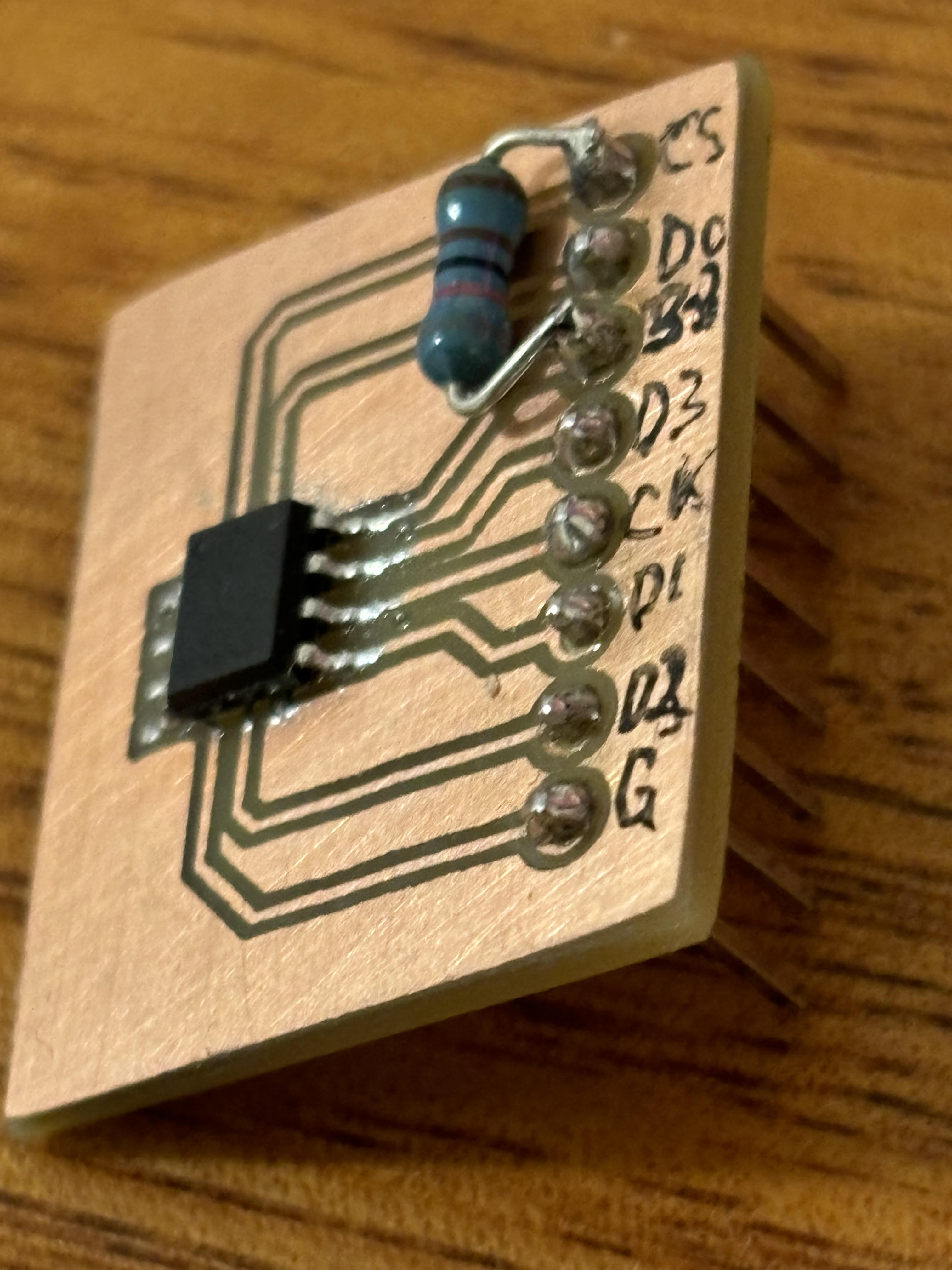

I've connected the PSRAM64H to the ESP32 using a small PCB I made (pic attached), and DuPont wires.
Perhaps the wires may be affecting the signal integrities.
That sounds likely, tbh.

1. In the circuit diagram, I've got SD2(ESP32) -> SD2(PSRAM), and SD3(ESP32) -> SD3(PSRAM), because I incorrectly aligned SIO2(PSRAM) and SIO3(PSRAM) with SD2 and SD3 on the ESP32.
2. However, at one stage I did swap these two connections around (so the PSRAM should have worked with the ESP32), but still found the PRSAM chip wouldn't work with the ESP32.
So, I made a PCB that mounts the PSRAM with the ESP32 (no flying wires!), and correctly connects SIO2(PSRAM) and SIO3(PSRAM) with SD3 and SD2 on the ESP32, respectively.
And now I have 4Mb of PSRAM working perfectly.
