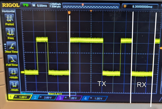

Hi all,
I have a project where I am attempting to communicate with a device using a one wire bidirectional data protocol via the RMT peripheral.
The general flow of the transmission protocol is as follows:
ESP32 Transmits
- 15 high bits (SOT)
- Start bit (0)
- Data bit
- Data bit
- Data bit
- Data bit
- Data bit
- Data bit
- Data bit
- Stop bit (1)
- Even parity bit
- 3 high bits (EOT)
ESP32 stops transmitting, starts listening.
ESP32 Receives
- Start bit (0)
- Data bit
- Data Bit
- Data Bit
- Data Bit
- 4 low bits
Repeat from the top.
I have gotten the TX part to work as intended and to be in spec. The device I am communicating with recognizes my ESP32 and reads the data bits I am sending.

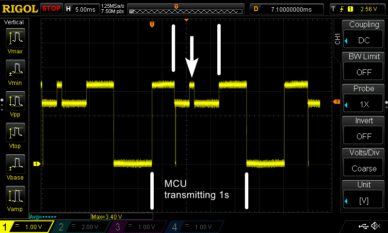

The problem is that when I stop transmitting and wait for 10 milliseconds for a response, the line is being held low by the ESP32 data pin (even with an external pullup resistor).
If I have the microcontroller not wait that 10ms, so it instantly starts transmitting the next SOT (high for 15ms), you can see on the oscilloscope where the external device is trying to transmit data.
Things I have tried:
  • Calling rmt_enable to enable the TX channel before my transmission, and then rmt_disable to disable it before waiting for the response.
  • Setting io_loop_back to all four combos of TT/TF/FT/FF for TX and RX respectively
  • Disabling open drain mode when transmitting data, and then enabling it when receiving data.
  • Having separate tasks for TX and RX, as well as using the same task for both
I figure there is probably some GPIO configuration that I am missing here, so any advice is appreciated.

Posts: 2705
Location: Europe, Germany
Re: Can't get receiving data to work with bidirectional RMT peripheral
Postby MicroController » Wed Jun 11, 2025 10:38 am
Sounds like you may need four things here:
1. Connect RX and TX to the same pin (e.g. internally via GPIO matrix)
2. Use internal or external pull-up resistor
3. Set the TX pin to open drain mode (INPUT+OUTPUT+OD if using the same pin for TX and RX)
4. Set the RMT TX "idle" level to high/"1"
