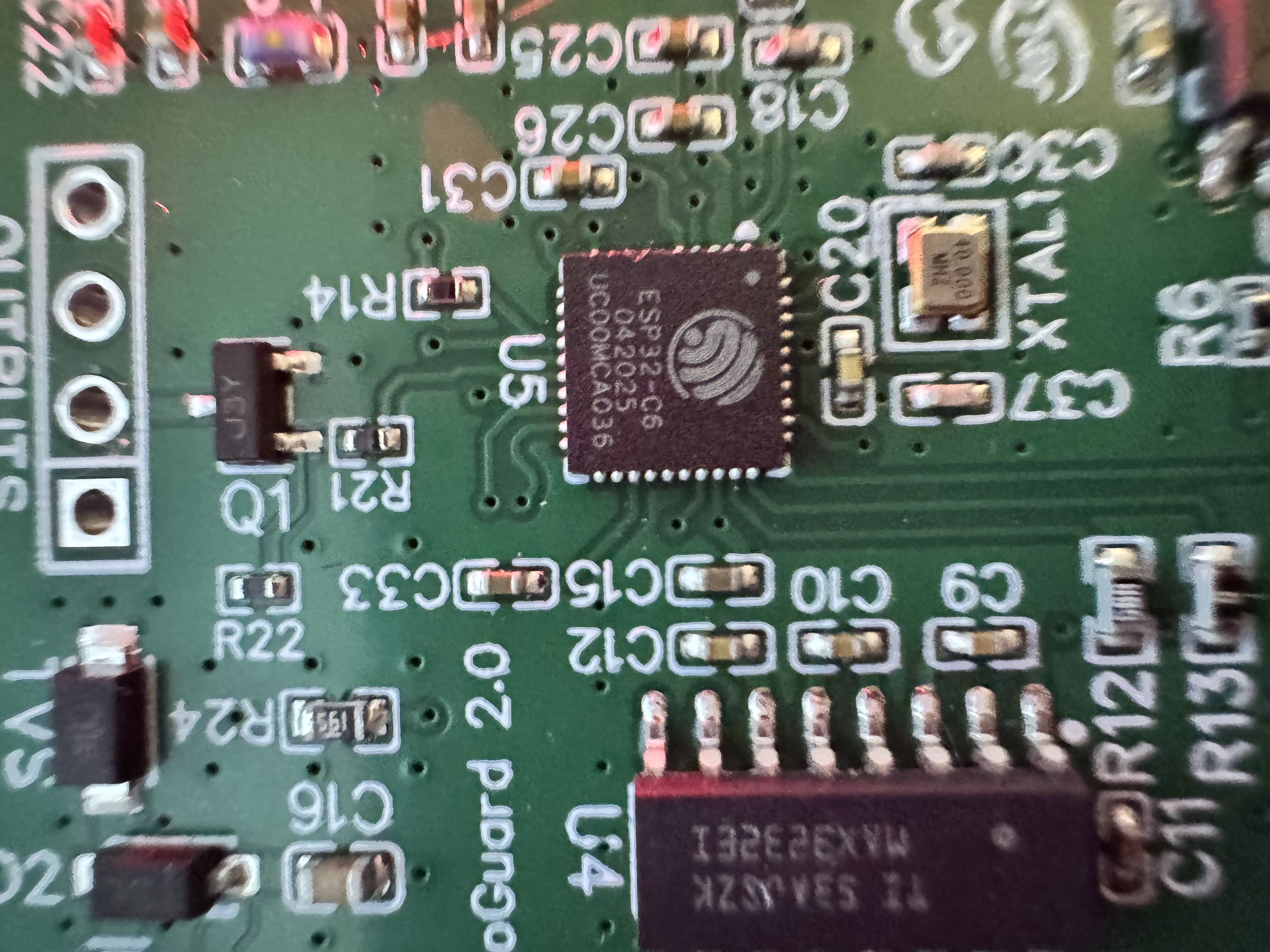

I have up to now been using an ESP32 C6 Zero board from WaveShare and programming it via the Arduino IDE, selecting board as ESP32 C6 Dev Module. I recently had a board made with the ESP32 C6 Chip directly on my board. When programming it, I get the following error:

A fatal error occurred: Packet content transfer stopped (received 0 bytes)

What do I need to do before I can program the chip in the normal way using the IDE, do I need to burn a boot loader or something?

That's usually an issue with the flash. Did you design in a flash chip on your board, or are you using an ESP32C6 variant with internal flash?

That’s a great question! I hope it’s internal flash! But now I’m thinking we have the wrong chip!

So it looks like we used a chip with no onboard flash oooops
