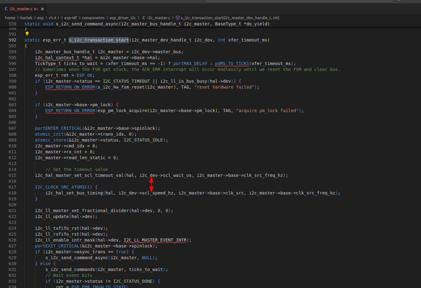

this is my code to interface of bmi323 with esp32s3 this code work fine but after some time getting error long below
E (250477) i2c.master: I2C transaction unexpected nack detected
E (250477) i2c.master: s_i2c_synchronous_transaction(872): I2C transaction failed
E (250477) i2c.master: i2c_master_transmit_receive(1097): I2C transaction failed
E (250487) i2c.master: I2C transaction unexpected nack detected
E (250487) i2c.master: s_i2c_synchronous_transaction(872): I2C transaction failed
E (250497) i2c.master: i2c_master_transmit_receive(1097): I2C transaction failed
Accel => raw-> x=-2538, y=-2604, z=15898 | mps2-> x=-1.52, y=-1.56, z=9.52 || Gyro => raw-> x=-2, y=-7, z=-1 | dps-> x=-0.12, y=-0.43, z=-0.06
E (251517) i2c.master: I2C transaction unexpected nack detected
E (251517) i2c.master: s_i2c_synchronous_transaction(872): I2C transaction failed
E (251517) i2c.master: i2c_master_transmit_receive(1097): I2C transaction failed
E (251527) i2c.master: I2C transaction unexpected nack detected
E (251527) i2c.master: s_i2c_synchronous_transaction(872): I2C transaction failed
E (251537) i2c.master: i2c_master_transmit_receive(1097): I2C transaction failed

To resolve the bug.You have to update i2c_master.c and change from
to
in other words move line i2c_hal_master_set_scl_timeout_val above I2C_CLOCK_SRC_ATOMIC
it works for me
I2C_CLOCK_SRC_ATOMIC() {
i2c_hal_set_bus_timing(hal, i2c_dev->scl_speed_hz, i2c_master->base->clk_src, i2c_master->base->clk_src_freq_hz);
// Set the timeout value
i2c_hal_master_set_scl_timeout_val(hal, i2c_dev->scl_wait_us, i2c_master->base->clk_src_freq_hz);Code: Select all
}it works for me
