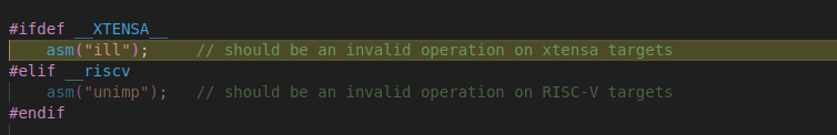

Hi to all, I'm trying to generate a tone to create a wav file using esp-idf 5.4.1 and I tried to use this peace of code:
const int buffer_size = 8000;
const int sample_rate = 8000;
    for(int i=0;i<buffer_size;i++)
        buff_test[i]=(short int)(cos((2 * M_PI * 256*i)/sample_rate)*1000);
and I also tried creating a lookup table with sin values and storing into a buffer, but in both cases I got this message:
At first I thought it was a library error (float numbers) but why do I got this error with a lookup table? Why Xtensa? I already compile this tone using clang and works.
Thanks
Gastón

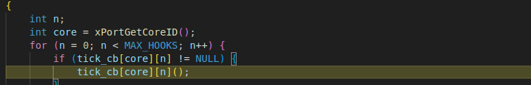

an update,
If I change the buffer_size value to less than 2000, I got it working. But why? I alreedy disable wdt timer from esp settings.
I'm using esp32 custom board with jtag esp-prog on es-idf 5.4.1.
Now if I use above 8000 of buffer_size I got this(see attachment). Don't know why I got this messages.

Postby MicroController » Fri Jul 04, 2025 10:08 pm
What "messages" are you talking about? I only see useless screenshots of some code snippets with 0 context.
Probably because you're corrupting some memory when you write 'too much' to the buffer.

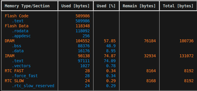

Microcontroller thanks for the reply, those codes is where the code is stopped. The debug halts there. I try to create a tone using the cos function and checking the build info I check that memory usage is correct. I also tried creating a lookup table for the cos function, but again the program halts in one of those two codes I uploaded. I attached the build info. and the tone coded is this:
const int duration = 2;
uint16_t buff_test[buffer_size];
uint16_t sample_rate = 8000;
int buffer_size = sample_rate*duration;
        buff_test[i]=(cos((2 * M_PI * 256*i)/sample_rate)*1000);
How may I be able to create a tone of 2sec duration in the esp32? is there an example code to check? If memory usage is a problem, why a lookup table also have the same issue? I observe that the code is also stopped in those codes using a sin lookup table for 16000 values.

Postby MicroController » Sat Jul 05, 2025 12:12 am
Let the code run and check the log output over serial via idf.py monitor. This may give a better hint at what's going wrong.

Postby MicroController » Sat Jul 05, 2025 7:36 am
This problem may be partially timing-related, as the actual error happens in the FreeRTOS tick interrupt, which may explain why it seems to work for smaller buffer sizes (=faster).
Still likely some memory corruption going on, maybe some stack-overwriting. Can't tell without seeing the code.
