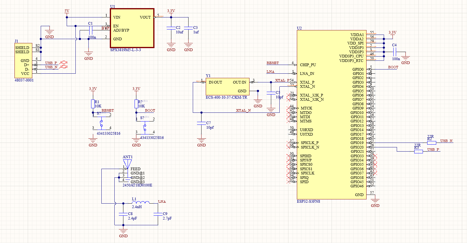

I need some technical support/help regarding the this issue. I have designed a custom PCB using ESP32-S3FN8 chip i am not able to upload any firmware to it neither able to get chip info using esptool. please refer to schematics below.

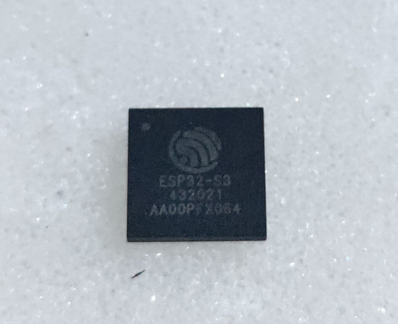

this is the chip i used.

please help me on guiding to solve this issue. I dont know if the chip is a legit chip or not.

Are you sure that indeed is an ESP32-S3FN8 and not a plain old suffix-less ESP32-S3? The latter does not have integrated flash and you also aren't using external flash, so it's no wonder you wouldn't be able to program the flash.

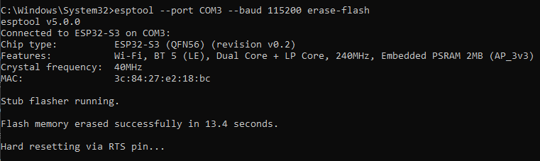

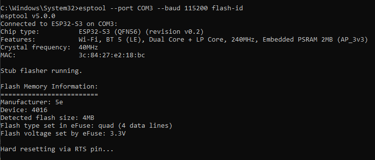

i am also not sure that it is an original ESP32-S3FN8 or not. I bought the chip from aliexpress and the seller mentioned it is legit, but i dont trust that. Later i connected an 4MB flash and i was able to upload the firmware with a serial print, just a simple serial print but it does not show anything on the terminal. Here is a screenshot of a reading chip and erasing after connecting an external flash. I am uploading via USB and after the reset it shows this message.

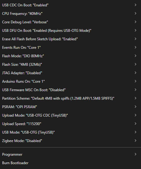

it seems something still not working right? i am using arduino IDE and following are my configurations
GPIO0 and GPIO46 pulled high please guide me on fixing the issue. if i need to make any hardware changes let me know.

Decently sure it's original as I haven't seen 'fake' ESP32 chips yet, but it's a different model than you were intending to buy.i am also not sure that it is an original ESP32-S3FN8 or not. I bought the chip from aliexpress and the seller mentioned it is legit, but i dont trust that.

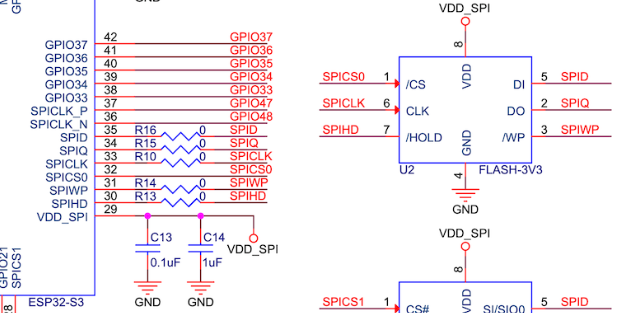

How exactly did you connect the flash? Also, what flash chip is it?Later i connected an 4MB flash and i was able to upload the firmware with a serial print, just a simple serial print but it does not show anything on the terminal. Here is a screenshot of a reading chip and erasing after connecting an external flash.

By the way, your schematic is... let's say, minimalistic to a fault. I see a lack of decoupling, no proper RC network on the EN pin, VDD_SPI connected straight to 3.3V, ... If you want this chip to actually work properly wrt WiFi/BT, I very strongly suggest you follow the hardware design guidelines we provide.

I have removed a flash chip from an ESP12F module and connected to ESP32S3 I followed the design guide for connecting it. I know there is lack of decoupling and stuff which will be fixed after testing.
later i have changed USB mode to Hardware CDC and was able to get the serial print output. But is this the right way? when i upload any sketch with wifi, like wifi scanner ... the terminal output shows its getting corrupted and stuff. So 4MB flash is not enough? (i erase the flash every time before uploading)

Impossible to say, but an error like that (especially if it happens at the exact PC every time, you could check that) tends to point at a software issue, not a hardware one. Normally, ESP-IDF detects the amount of flash and throw an error if it's less than the program needs, so I don't think the size by itself is a problem.
