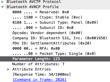

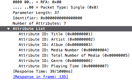

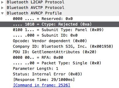

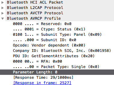

I attached screenshots from Wireshark showing incomplete request, rejected response and
a proper message from a RN52 bluetooth module.
Proper request from a RN52 bluetooth module
Screen Shot 2017-09-30 at 16.03.10.png (46.71 KiB) Viewed 20009 times
Rejected response from smartphone
Screen Shot 2017-09-30 at 15.56.20.png (48.07 KiB) Viewed 20009 times
Incomplete metadata request
Screen Shot 2017-09-30 at 15.51.42.png (46.22 KiB) Viewed 20009 times

AVRC_BldCommand does not know how to build AVRC_PDU_GET_ELEMENT_ATTR
https://github.com/espressif/esp-idf/bl ... _ct.c#L212
Somebody did it here (backport I think) https://github.com/denisigo/fireprime_e ... 43d7c55b18

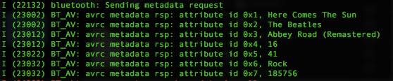

Postby Sinisa_PUF » Tue Oct 03, 2017 3:16 am
I've got it.
Thanks again WiFive.
Here's my commit.
There is still a few things I need to touch up but when i'm done I'll make a pull request.
Screen Shot 2017-10-03 at 05.08.33.png (54.76 KiB) Viewed 19946 times
