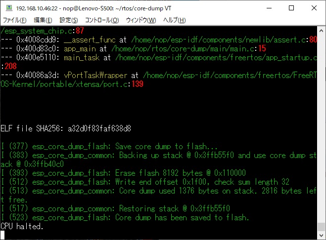

Postby nopnop2002 » Thu Aug 07, 2025 11:37 am
I used the following code:
#include <stdio.h>
#include <inttypes.h>
#include "freertos/task.h"
#include "esp_log.h"
void app_main()
        printf("Now esp is crashed\n");
        assert(0);
I used this partition:
# Name,   Type, SubType, Offset,  Size, Flags
# Note: if you change the phy_init or app partition offset, make sure to change the offset in Kconfig.projbuild
nvs,      data, nvs,     0x9000,  0x6000,
phy_init, data, phy,     0xf000,  0x1000,
factory,  app,  factory,,         1M,
#coredump, data, coredump,,        64K
coredump, data, coredump,,        0x10000,
The Coredump will be saved.
Running on esp-idf v5.4.2
$ idf.py --version
ESP-IDF v5.4.2-dirty

ELF file SHA256: a8179f5b9a7fcd8f
I (10289) esp_core_dump_flash: Save core dump to flash...
I (10295) esp_core_dump_common: Backing up stack @ 0x3ffb5650 and use core dump stack @ 0x3ffb3d40
I (10304) esp_core_dump_flash: Erase flash 8192 bytes @ 0x10000
I (10519) esp_core_dump_flash: Write end offset 0x1e40, check sum length 32
I (10520) esp_core_dump_common: Core dump used 1296 bytes on stack. 2884 bytes left free.
I (10523) esp_core_dump_common: Restoring stack @ 0x3ffb5650
I (10528) esp_core_dump_flash: Core dump has been saved to flash.
CPU halted.
The core dump appears to be stored correctly in flash.
I don't know the cause of this error.
If you have another ESP32 development board, try it on that board.
