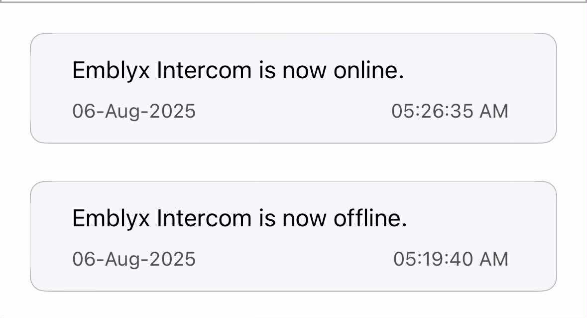

I have a problem where my device gets an Offline notification for 1-5 minutes at random times (e.g., 2-3 times per day).

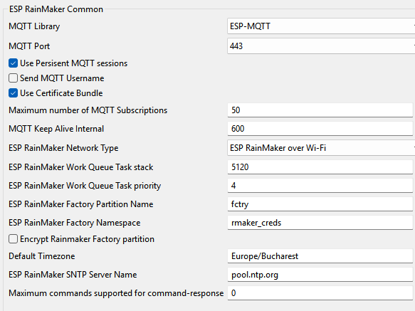

- using Rainmaker MQTT Alive interval of 600
- I have tried different values and combinations (e.g., mqtt alive intervals to 30 mins, etc), but the result is the same
Offline Notif:

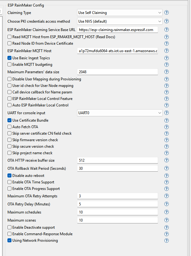

Rainmaker config:

When you say "- confirmed that the ESP is not losing wifi connection when offline notification occurs, nor getting reset, or anything.", is it based on the user experience or from actual serial terminal logs? Is there any difference depending on enabling/disabling power save and/or changing the keep alive interval? In cloud logs, we just see "Connection Lost" as disconnect reason.

I have a wifi reconnect implementation with serial information, and there is nothing written when the offline notification happens. Although I am handling the SAR power domain for ADC separately, to achieved a lower power consumption, and that is affecting the WIFI in some corner cases (wifi thinks is still connected but is not).
Using wifi power saving MIN mode instead of MAX solves this problem, since it is keeping the wifi active always.
