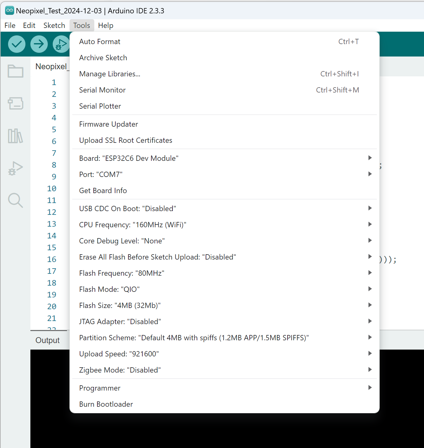

Also, here are my settings in Arduino. Do any of those need changed?
Screenshot 2024-12-05 061338.png (166.44 KiB) Viewed 6609 times
Thanks everyone!

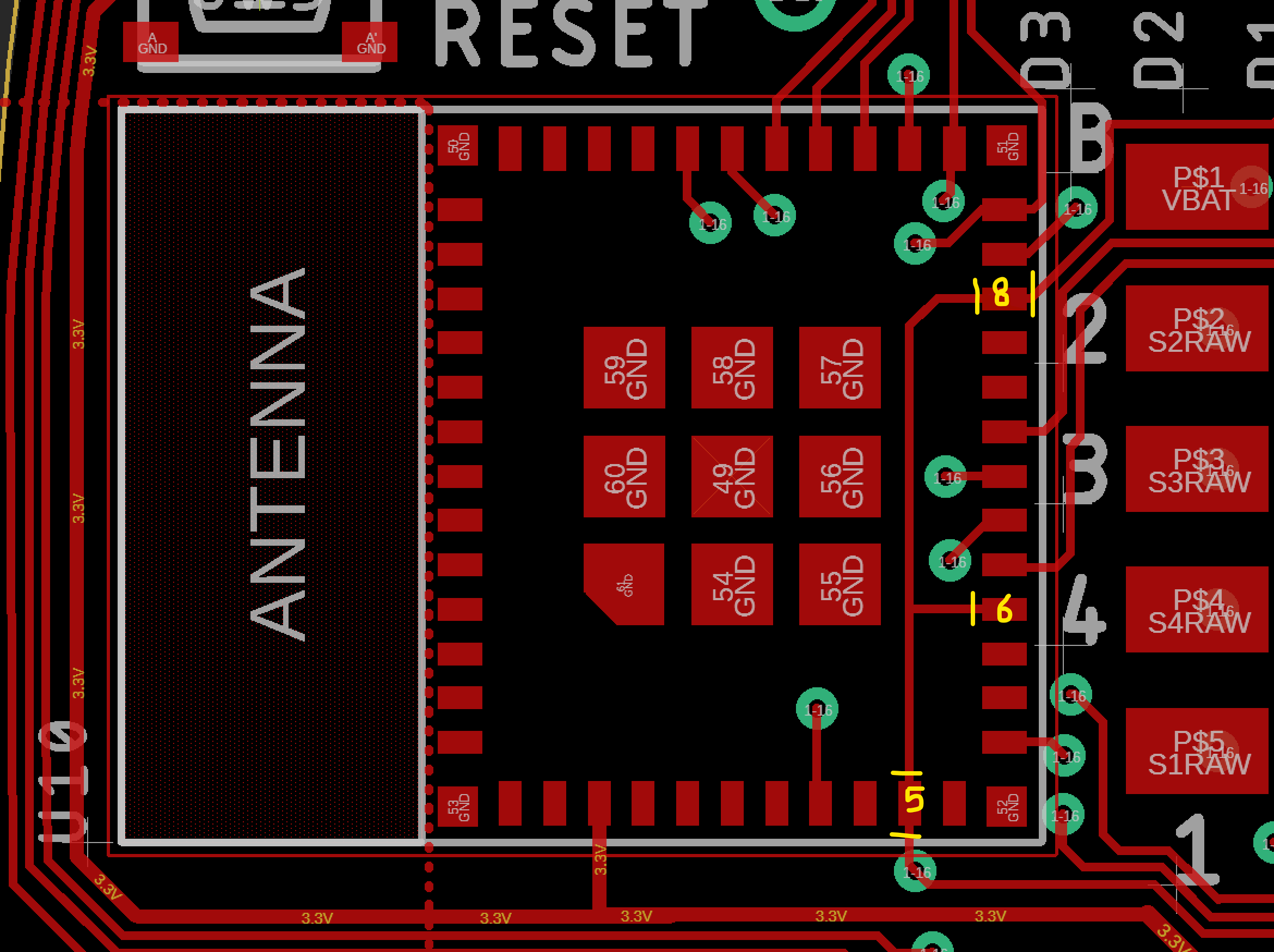

One more thing: In my design, I'm tying MTMS, IO8, and IO15 together in a net called ALARM and actuating that line with my RTC chip. I don't recall why I tied all of those pins together, but it wasn't a great idea. According to the ESP manual, those are all supposed to float, maybe even relative to each other? Even though the RTC's MFP (multi-function pin) is supposed to be open collector, for some reason, that net is being pulled down on my board. Of course the traces that connect these pins together are under the ESP, so I'll put one more together with that net removed and see if that helps. If so, I'm going to revise the design to leave all of the strapping pins alone. I'm not even using IO 1-4...
Does this seem like a likely culprit?

I can't see what you have gpio8 tied to, but it should be held high at boot. gpio8 and 9 are the strapping pins. If you are going to build your own boards, get used to reading the datasheets or you are sure to run into some gotchas.
Well, I modified a bare board as shown below (GPIO pin numbers on pads) to take those pins off of the ALARM net. I left 8 floating, which is exactly what Adafruit did on their board, and it's still behaving the same way. I wish I would've done the trace cut further away so I could stick a pullup wire to it, but now I'm warming up the ol' vapor phase to attempt to pull the module off of one of my original two boards so I can modify the traces differently and attempt to re-reflow the module back on... nothing to lose at this point! I sure wish I would've brought them all out to solder jumpers, at least!

Alright... I successfully removed the module from one of my boards, reworked the board so I could put a pullup on IO8, then re-reflowed it. Same result. It's still spitting out "ESP-ROM:esp32c6-20220919" regardless of resetting with IO9 low or high...

Assuming you are uploading on USB, you need to set USB-CDC to enabled. The first time you upload with that setting, you will need to hold the boot pin low, but after that, the board will be able to signal over USB that it is going to upload, so you won't need to hold the pin down. You probably also want to enable the jtag adapter over usb, so you can see the output.
The only other thing that affects the ability to upload (or boot even) is the RC timer circuit on the enable pin. Your 5k/1uF combo is a bit shorter than the 10k/1uF recommended, but I think it should be adequate.
