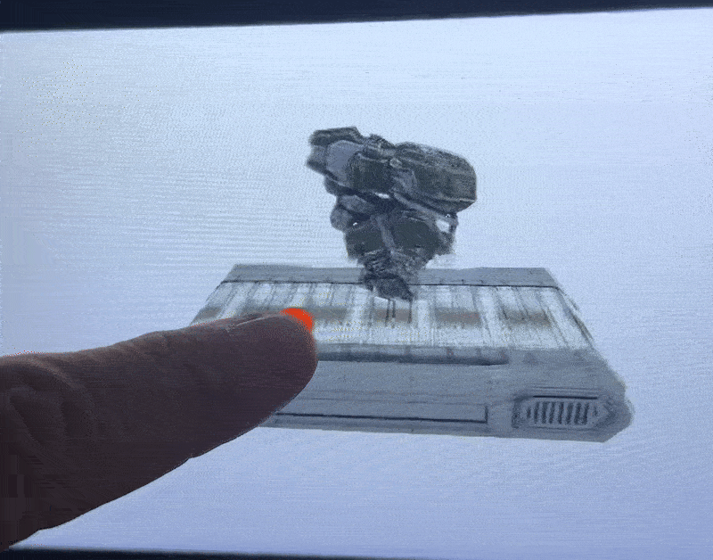

Based on the tgx library (https://github.com/vindar/tgx) with a couple of performance optimizations and added features like multi-threaded rendering, scene-graph, animations and collada import.
The 3D model is a hand optimized mesh based on a design by @nabonilo
This scene renders at ~30fps on a 1024x600@16bit framebuffer
Video in better quality:
http://youtube.com/shorts/fdm1TQ1i_iM
3D rendering on the ESP32-P4
