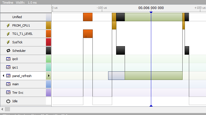

So - back to the original problem. Occasional flickering during LED panel refresh.
You can clearly see here that the timer interrupt is firing and shortly after the panel_refresh is called. But notice how it goes into idle in between?
    EventBits_t mybits = xEventGroupGetBitsFromISR( panel_event_group);
    if (mybits & PANEL_REFRESHING){
        xEventGroupSetBitsFromISR(panel_event_group, PANEL_REFRESH_CLASH, &xHigherPriorityTaskWoken2);
    } else {
        xEventGroupSetBitsFromISR(panel_event_group, PANEL_REFRESH_TRIGGER, &xHigherPriorityTaskWoken);
       if( xHigherPriorityTaskWoken) {
            portYIELD_FROM_ISR();
My understanding is that the xHigherPriorityTaskWoken should kick off the yield which should make the actual panel refresh happen pretty much immediately (that task is running at priority 25), but surprise, the "portYIELD_FROM_ISR()" is not being called (confirmed by adding an 'else' to the if statement). The PANEL_REFRESH_CLASH was extra code to try and check if the refresh was being called while the panel was actually being refreshed (it isn't). I'm not sure why FreeRTOS doesn't understand there's a higher priority task, waiting to run. Interesting, and this code is common throughout the IDF, so I'd like to solve it, but that isn't a show stopper.
I am interested in this FROM_CPU1 task is though - and that it's purpose is. I'm just surprised that it's not SysTick-Scheduler-PanelRefresh.
But otherwise, give or take, we have a timer and (shortly thereafter) we have a panel_refresh. Fine.

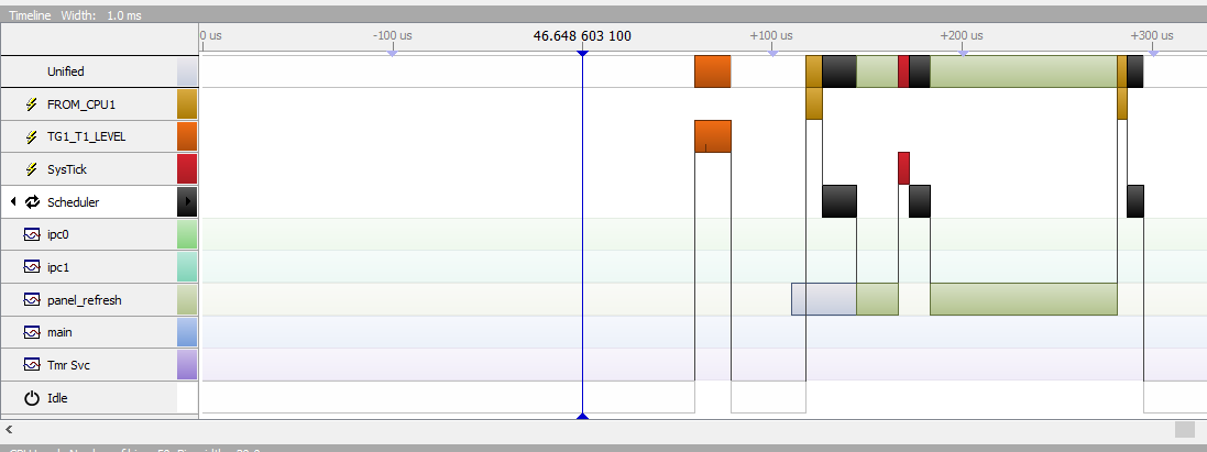

But have a look at this one:
See how smack in the middle of doing a panel refresh, SysTick pops in to say hello. Now I have tried ALL sorts of things to stop this happening - to be clear I haven't tried these things and run SysView, but the result is the same (flickering), as mentioned in the original post. I really just want SysTick to take a holiday for a moment and let the panel_refresh happen as quickly as possible.
Any thoughts?

igrr
Posts: 2077
Re: Timer group performance
Postby igrr » Mon Sep 25, 2017 4:53 pm
A few questions first:
Have you tried running the code in single core mode? That is not the solution, but it would probably make it easier to see the whole situation in Systemview.
Can you paste the line of code you are using in the panel refresh task to wait on panel_event_group?
Is the panel refresh task pinned to a particular core? (i.e. is it created using xTaskCreate or xTaskCreatePinnedToCore?)
Now to the answers.
FROM_CPU1 is an interrupt, not a task — this is indicated by a lightning icon next to it. This interrupt is used in FreeRTOS to notify the scheduler on CPU0 that it may need to re-evaluate which task to run. As the name indicates, this interrupt is triggered on CPU1. There is a similar interrupt, FROM_CPU0, which is used for notifications in the other direction. So if FROM_CPU1 triggers, it means that something has happened on CPU1, that made the scheduler think that CPU0 may need to know about that. Without knowing more about your application, i can't really say what that might be.
Regarding SysTick interrupt interrupting your task, what you can do is try disabling interrupts temporarily. This can be done e.g. using
uint32_t state = portENTER_CRITICAL_NESTED();
// your code
portEXIT_CRITICAL_NESTED(state);

wobblyboots
Posts: 19
Joined: Mon Sep 18, 2017 4:48 pm
Postby wobblyboots » Mon Oct 02, 2017 7:21 pm
Thanks ESP_igrr. I switched to single core mode and ... it's rock solid. No flicker. Switch the other core on, and it flickers, about every 10 seconds it goes through a flickering state for a second or so and then returns to normal.
However since sprite has been able to outsource the entire driving of the LED panel to the I2S DMA, including getting a few more bits of brightness on a per-pixel basis we will probably park out efforts here and leapfrog off his work.
In any case, an interesting learning experience.
Ian.
