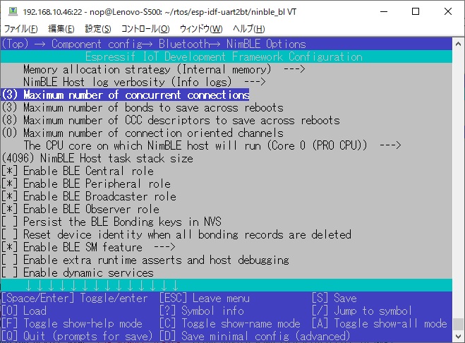

Hi everyone, need a hand here
When the ESP32 operates as a BLE central device, it can only pair with up to three BLE peripherals and maintain active connections, even though Espressif documentation mentions it can connect to 7–10 devices.
Is there a reason for this limitation? Is there any solution to increase the number of active BLE connections?
Also, is there any ESP32 variant that can pair with 30–50 BLE peripherals and keep all connections active, or any other microcontroller you could recommend that supports this capability?

Postby nopnop2002 » Wed Sep 03, 2025 1:57 am
Please check here when using the ESP-NimBLE host stack.
