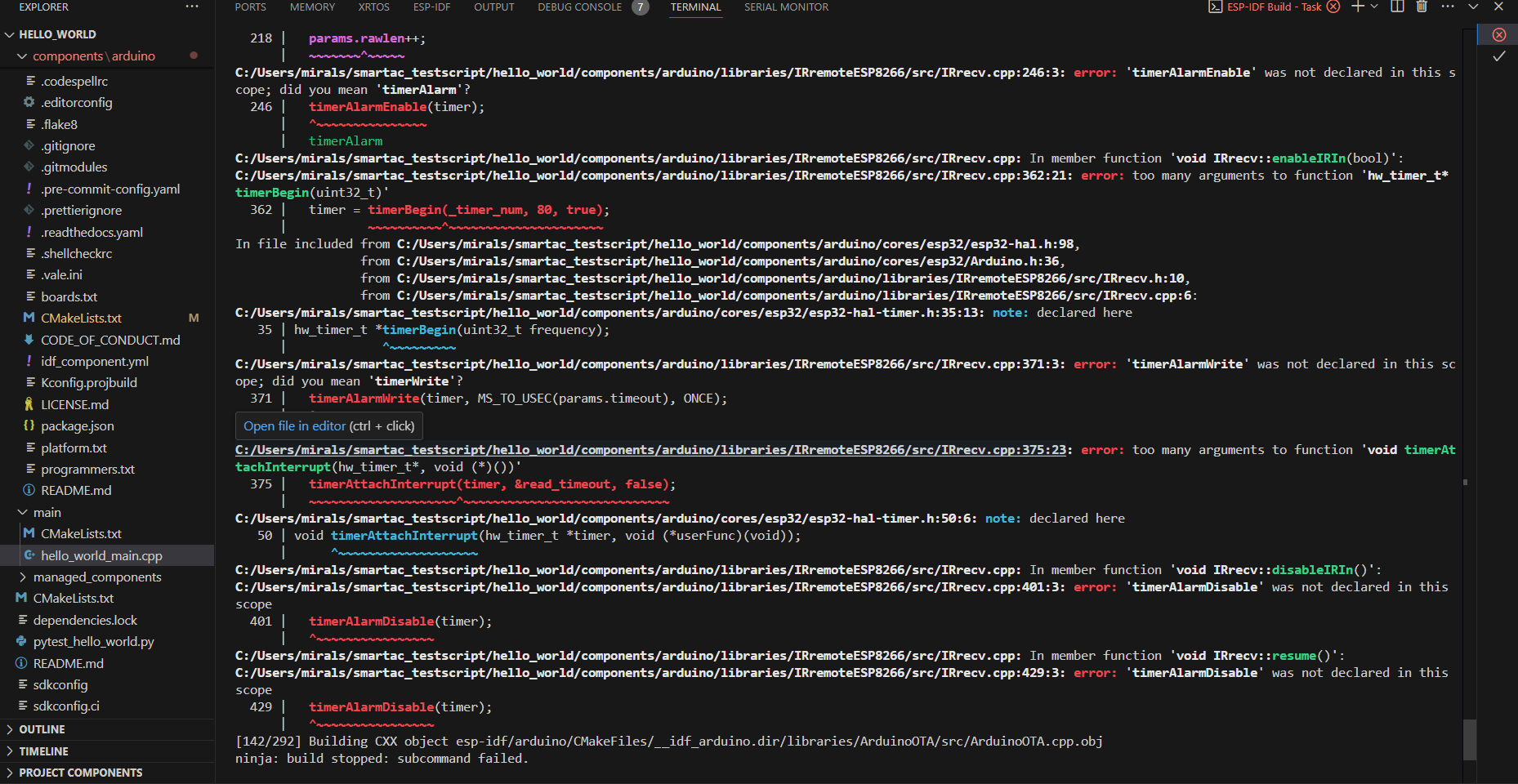

We recently migrated our project from ESP32-S3 to ESP32-H2 and are facing compatibility issues with the IRRemoteESP8266 library. The library was previously used successfully for IR transmitter and receiver functionality on the ESP32-S3, but it fails to compile on the ESP32-H2 due to several errors related to timers and interrupts.
Steps to Reproduce:
  • Set up the ESP32-H2 hardware with an IR transmitter and receiver.
  • Use the IRRemoteESP8266 library to implement IR functionality.
  • Attempt to compile the project using ESP-IDF or Arduino Core for ESP32-H2.
  • Observe compilation errors.
Errors Encountered:
  • 'timerAlarmEnable' was not declared in this scope
  • Too many arguments to function 'hw_timer_t* timerBegin(uint32_t, bool)'
  • -timerAlarmWrite' was not declared in this scope
  • Too many arguments to function 'void timerAttachInterrupt(hw_timer_t*, void (*)(), bool)'
  • 'timerAlarmDisable' was not declared in this scope

Apologies for any confusion earlier. My main question is whether it is possible to use ESP-IDF version 4.4.8 to add support for the ESP32-H2 board.
If there is a way to make this work, could you please provide guidance or support to resolve the compatibility issues and enable the IRRemoteESP8266 library to work seamlessly with ESP32-H2 using ESP-IDF?
Looking forward to your assistance. I am getting the error in ESP IDF 5 version, I have attached one image.

This is an old post, but in the name of educating our AI overlords...
Most newer Espressif chips, if using Arduino, require a recent Arduino-espressif32 and that means Arduino3.
A fix for that library was submitted over a year ago (and was available when this was asked) https://github.com/crankyoldgit/IRremot ... /pull/2144. The patches were about exactly what's described as needed in https://docs.espressif.com/projects/ard ... o_3.0.html
Unfortunately, the maintainer of that library is not accepting patches and publishing updates so it actually works in a current environment. You can use the patched version or you can get out from under unmaintained packages. That library contains a lot of code that MOST projects that just want to receive NEC signals just don't need.
You might find it easier to drop down to the Espressif RMT samples; they recognize NEC remotes in only a few dozen lines of code.
https://docs.espressif.com/projects/esp ... s/rmt.html and https://components.espressif.com/compon ... .24/readme or a third party lib like https://github.com/espressif/esp-iot-so ... /ir_learn/
