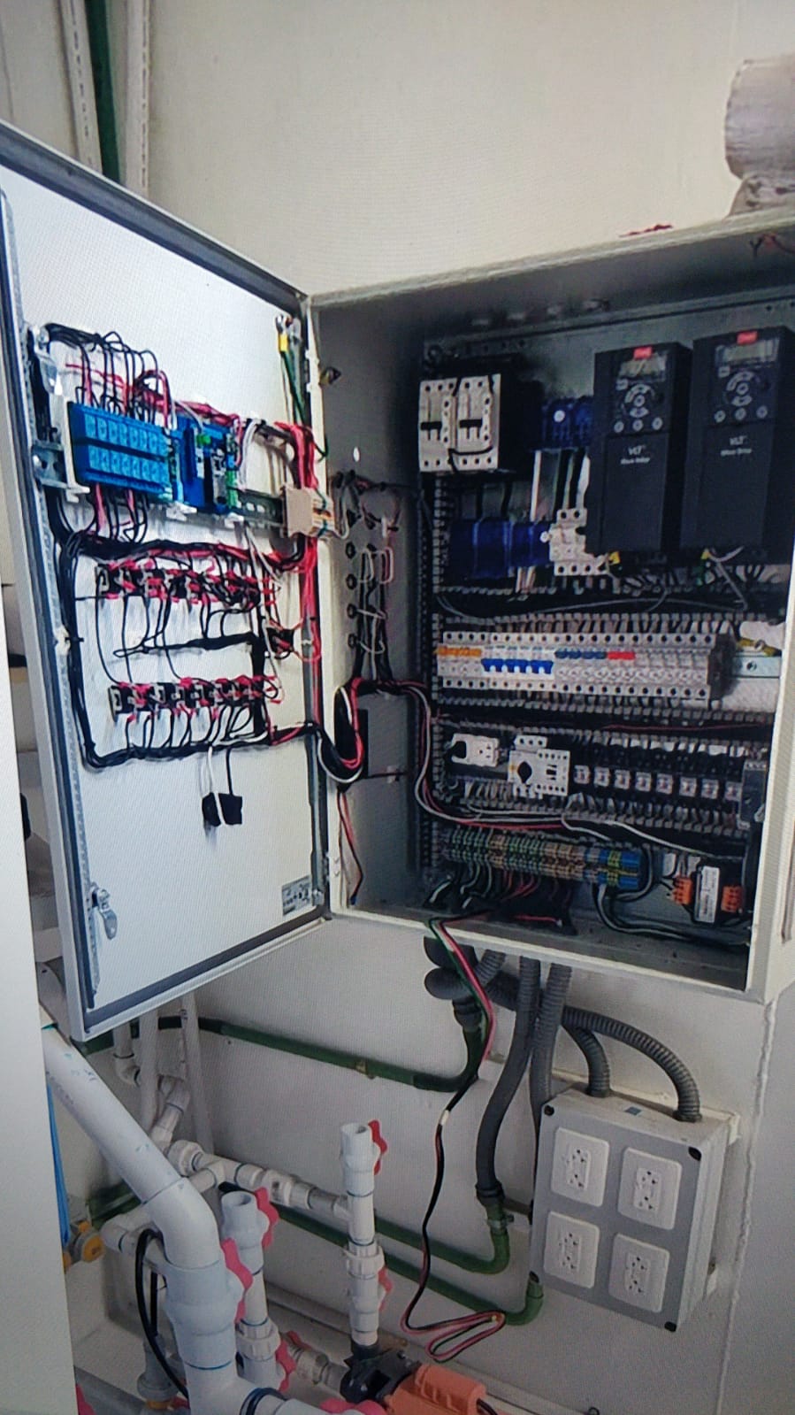

ShrimpBox control center. The Esp32 controls 16 relays by Modbus and the 2 VFDs also by Modbus. Also has an ESP8266 device called Jellyfish that monitors the PH, Temperature and Salinity of the water.

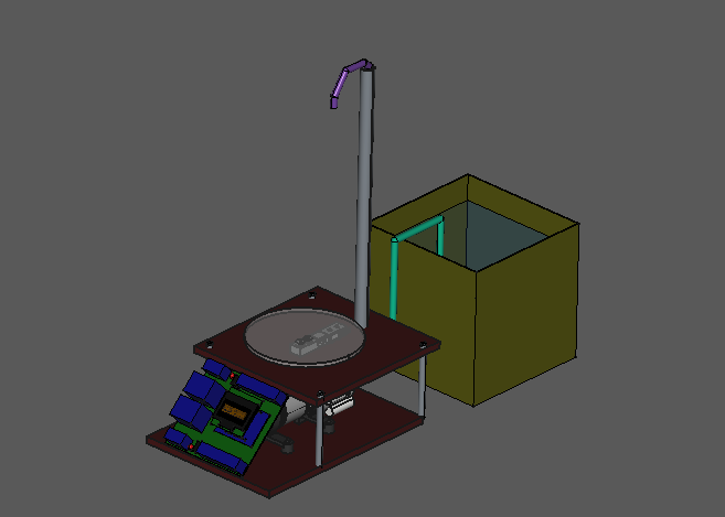

I'm working on a prototype for a gravimetric liquids dispenser based on the Esp8266 on a Wemos D1 Mini with a 12 volts pump driven through a transistor by PWM from D5 of the mini, a load cell connected to D0 and D8 and a push button to D7. I'm using the custom Firefly firmware to build this machine.
Liquids Dispenser 3D render
Prototype Video
https://youtu.be/bmZOhdgTDt0

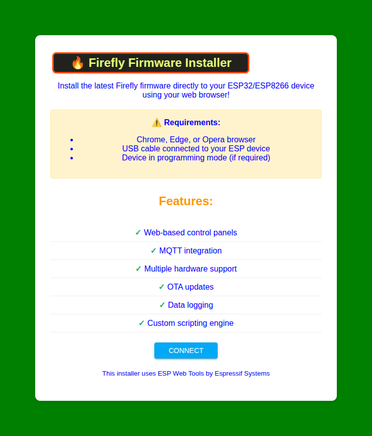

- I created a simple web uploader to flash the firmware and now compile for both ESP8266 and ESP32 devices correctly. It makes trying the firmware very easy as there is no need for libraries or dependencies. https://mfacen.github.io/firefly-web-installer

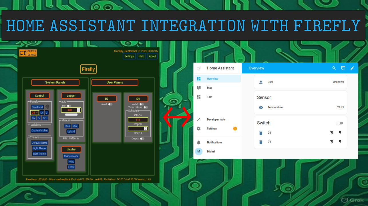

I added Home Assistant Auto Discovery features, now the panels you create in Firefly show automatically in the Home Assistant Dashboard.
Made a small video showing how it works: https://youtu.be/JSUjlUwRUj4
