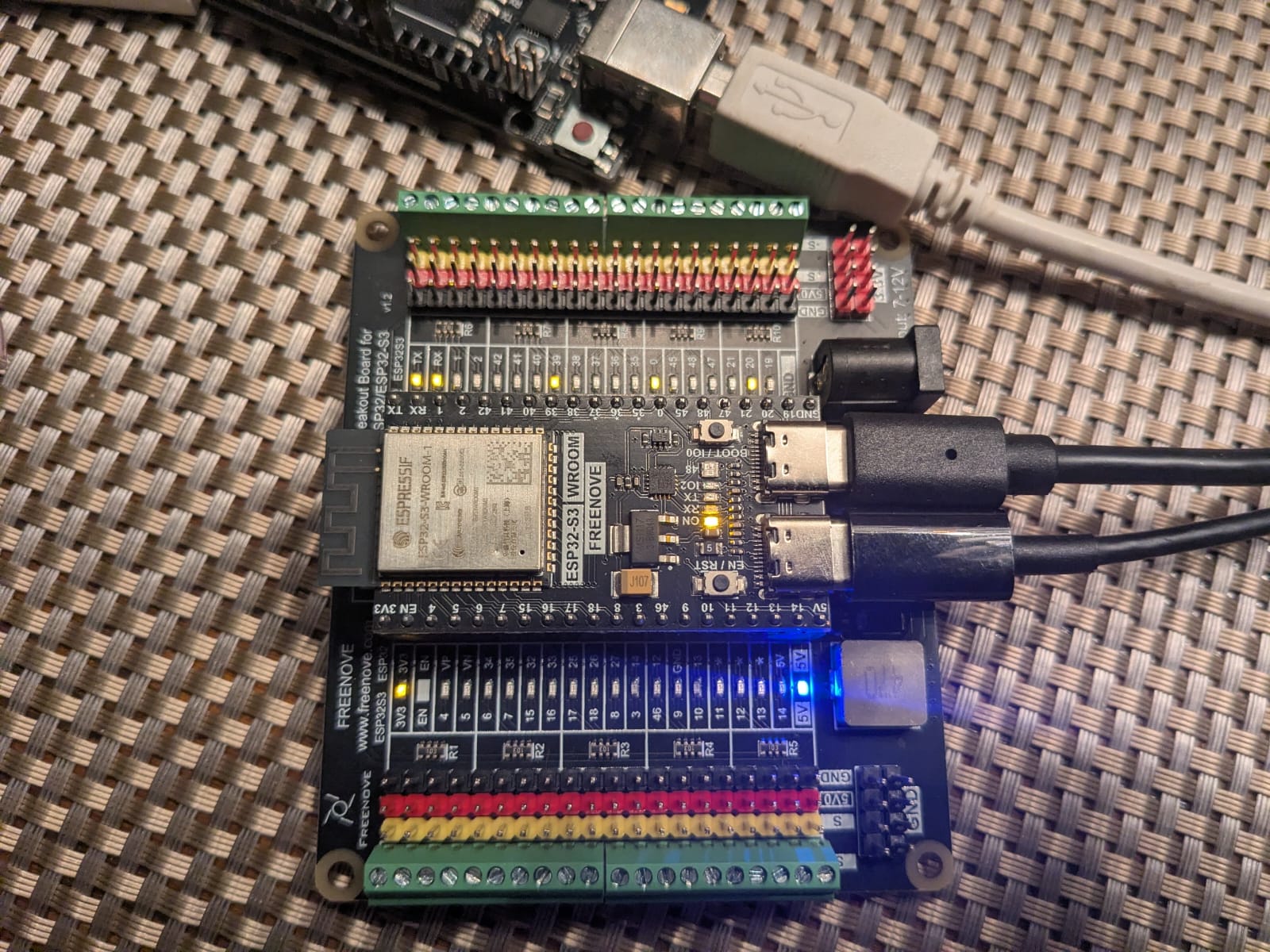

Hardware/Software/IDE:
Expressif ESP32-S3-WROOM-1
Libraries: installed ESP32 by ExpressIF
Arduino IDE 1.8.4, and Arduino IDE 2.3.4
I've successfully connected to my ESP32-S3 (dev kit, with adapter board). The code worked,
the LED flashed, I was able to change the duration of the LED on-time, etc. So, connecting
and manipulation is fine on basic code.

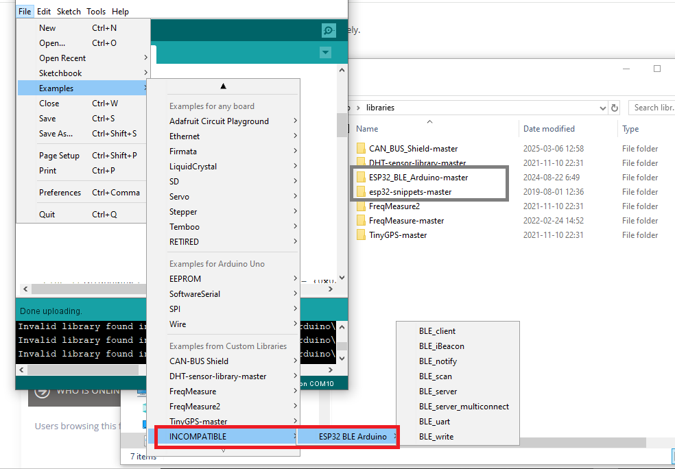

Postby YellowGTM » Fri Oct 10, 2025 2:35 am
Thanks for the response, @horrace99
The code in the OP was copied from a site, based on the library examples (GitHub, I think?)
When I go to examples, this is what I see. I think we're onto something:
I'll see about getting the core number as well!
lbernstone
Posts: 1131
Re: Fatal Compile Error(s)
Postby lbernstone » Fri Oct 10, 2025 4:11 am
You should remove any additional libraries you have added for BLE, as the BLE library is included in the core code you install for Arduino ESP32. It is complaining about extra libraries, and getting confused about what to install, since there is overlap.

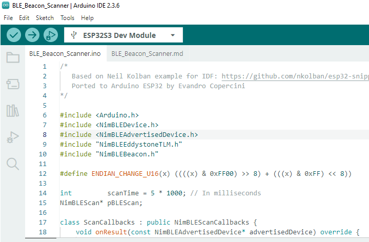

Postby YellowGTM » Tue Nov 04, 2025 11:28 pm
Thanks for the tip. I didn't anticipate this much trouble starting off, but
I've made some progress since the last post, with help from all of you.
I've essentially updated the IDE, removed any recent Bluetooth/BLE libraries
and started over.
Was able to upload code, communicate, manipulate, etc. For those that
are experiencing the same troubles, I read a thread on this forum with
respect to "Bluedroid" and "NimBLE" compatibility.
viewtopic.php?t=35193
With the NimBLE libraries, I was able to get up and running.
