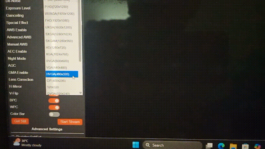

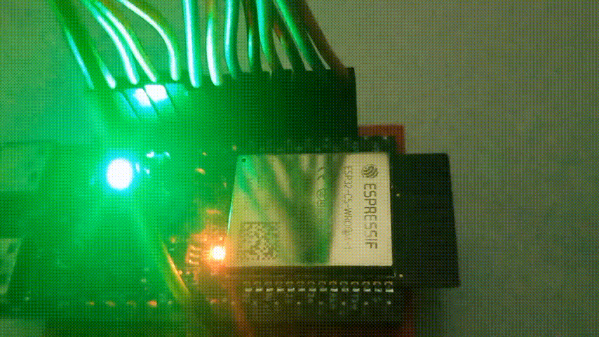

I have successfully be able to interface DVP camera with ESP32-C5 (Or targets supporting Parallel IO peripheral) to achieve 5GHz connectivity without the need to use other SoCs.
This is useful for example, a cost-effective single-chip applications requiring Wi-Fi 6 connectivity. For my use case, it is a dual-band Wi-Fi surveillance camera.
For OV5640, I was able to get ~28fps up to SVGA, ~32fps at HVGA, ~22fps on 1280x960, ~30fps on HD, ~13.5 (max) on FHD/WUXGA as well as QXGA/QSXGA (~10fps max) in its default setting.
You can refer to High Performance Mode (HPM) to require higher frame rates on OV5640 and OV3660. I would say it is comparable to Xtensa chips.
Overview of the connection of the ESP32-C5 & OV5640 camera.
The image streaming test.

Hello, thanks for reaching out! Well, since the ESP32-C series, including ESP32-C5 have limited number of GPIOs (In this case: 22), I tend to buy OV5640 camera modules with integrated crystal (most of them are 24MHz), so you would occupy at least 11 GPIO pins (8 data + 1 pixel clock + 2 SCCB pins) on the ESP32-C5. Connecting them is simple enough, hardware side. For prototypes purposes, I just use a breadboard and a few short jumper wires (5cm works best), connecting the wires from the camera pins to the ESP32-C5-DevkitC-1, which you set it in your application code. I did attempt to use this with PCBs so it would have less interference to sample higher PCLK rate.
For building applications, you can refer to the ESP-IDF (esp_cam_io_parl) component examples and try it out on your ESP32-C5-DevkitC-1. I've used the Parallel IO peripheral on ESP32 compatible targets, each have their limitations, such as HREF signals can't be used on a 8-bit DVP on ESP32-C5.
In my case, the connection from the OV5640 module to ESP32-C5-DevkitC-1 is this:
SDA -> 26, SCL -> 25, PCLK -> 2, D0 -> 10, D1 -> 9, D2 -> 8, D3 -> 7, D4 -> 6, D5 -> 1, D6 -> 0, D7 -> 3

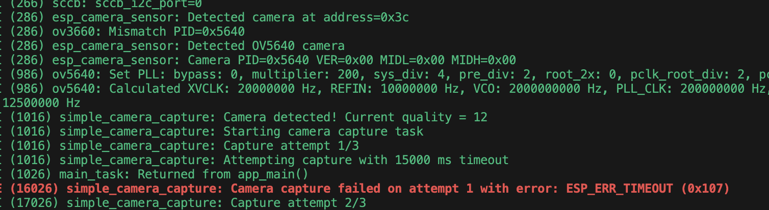

I actually was able to get the pin mapping and connected the relevant pins and tested the
Simple Camera Capture
code and got successful image capture logs, though when I tried again after some time, I now am only getting capture failed due to timeout errors. Do you know what could be going wrong here?

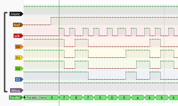

Just as an additional note: there appears to be a bug in the SDK related to the sampling edge.
In the camera example, config->pclk_sample_edge is never initialized, so it effectively defaults to PARLIO_SAMPLE_EDGE_NEG (0). As a result, parlio_rx_soft_delimiter_config_t.sample_edge is also set to NEG, yet the code still works.
        parlio_rx_soft_delimiter_config_t rx_delimiter_config = {
            .sample_edge = config->pclk_sample_edge,
            .eof_data_len = esp_cam_io_parl->payload_size,
            .timeout_ticks = 0,
  typedef enum {
    PARLIO_SAMPLE_EDGE_NEG, /*!< Sample data on falling edge of clock */
    PARLIO_SAMPLE_EDGE_POS, /*!< Sample data on rising edge of clock */
} parlio_sample_edge_t;
Here is the first HREF after VSYNC. The bytes ff f8 (low bits → f and 8) should definitely be sampled on the rising edge:
In C6 driver code comments are broken: https://github.com/espressif/esp-idf/bl ... ruct.h#L72
        /** rx_clk_edge_sel : R/W; bitpos: [26]; default: 0;
         *  Write 0 to enable sampling data on the rising edge of rx clock. Write 0 to enable
         *  sampling data on the falling edge of rx clock.
I can not find register definition for esp32c5, but for esp32c6, O in PARL_IO_RX_LEVEL_SUBMODE_SEL means Rising Edge.
I believe it can be due to power glitching, which may cause the OV5640 to accidentally reset though power cycle, and halts the DVP port as well, and based from the information that you had given to me, using the breakout board with jumper wires to connect to the ESP32-C5 are definitely the cause :D.

Yes, I'm glad that you've reached out to this. Earlier in development, I was investigating the issue on why it didn't sample correctly when I used the data sampling on the positive edge PARLIO_SAMPLE_EDGE_POS (I've tested on ESP32-C5/C6/H2) which then I've realized, the enum values may have been swapped/wrongly named, or maybe it was referring to the TX side of the Slave device which updates the data on defined edge (either falling or rising), I was unsure, but the naming seems to be directing to the PARLIO RX itself so I guess it could be wrongly labeled. The camera did latch the data lines on negative-edge and that is why I've exposed this property:
.pclk_sample_edge
... and let it be by default value. So users can set the sampling edge with their heart's content. I was also unsure whether the issue is only occurring on my end.
I will definitely address this in the esp_cam_io_parl ESP-IDF component as well, as the next beta revision was already undergoing for over two months ;).
