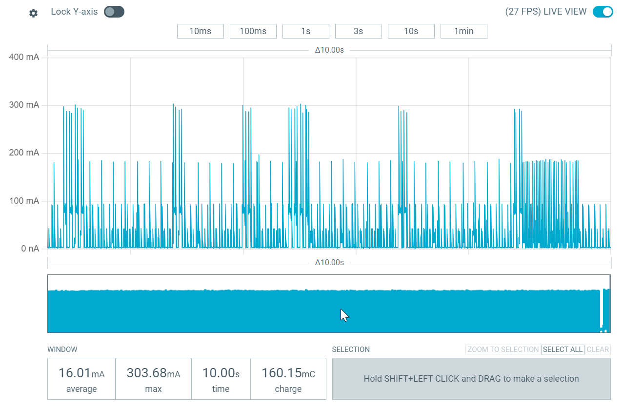

Re: [esp32c6] [ble_hid_device_demo] power consumption on light_sleep
Dear Espressif Support Team,
I have resolved the previous issue.

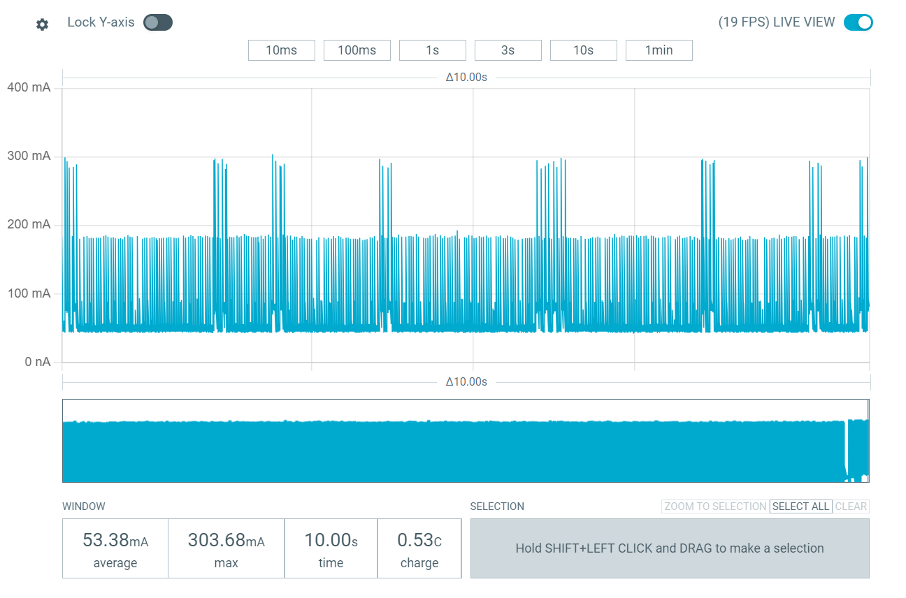

However, while testing the power saving feature with Wi-Fi in station mode connected to an AP, I encountered a new problem.
After about 30 seconds, the BLE connection is disconnected.
When the BLE reconnects, the current consumption increases significantly, from about 15 mA to 50 mA.
Could you please advise how to fix this issue or provide any recommended configuration to maintain stable BLE connection during Wi-Fi power saving?
Additionally, I would like to know how to keep the BLE connection stable and prevent it from disconnecting while Wi-Fi power saving is enabled.
Thank you for your support.

W (864) BLE_INIT: BLE modem sleep is enabled
I (864) BLE_INIT: Modem BLE MAC retention initialization
W (874) BLE_INIT: Enable light sleep, the wake up source is BLE timer

I (14104) HID_DEMO: esp_wifi_set_ps().
I (14104) wifi:Set ps type: 1, coexist: 1
I (24104) HID_DEMO: release s_no_sleep
W (41024) BT_HCI: hcif disc complete: hdl 0x0, rsn 0x8
