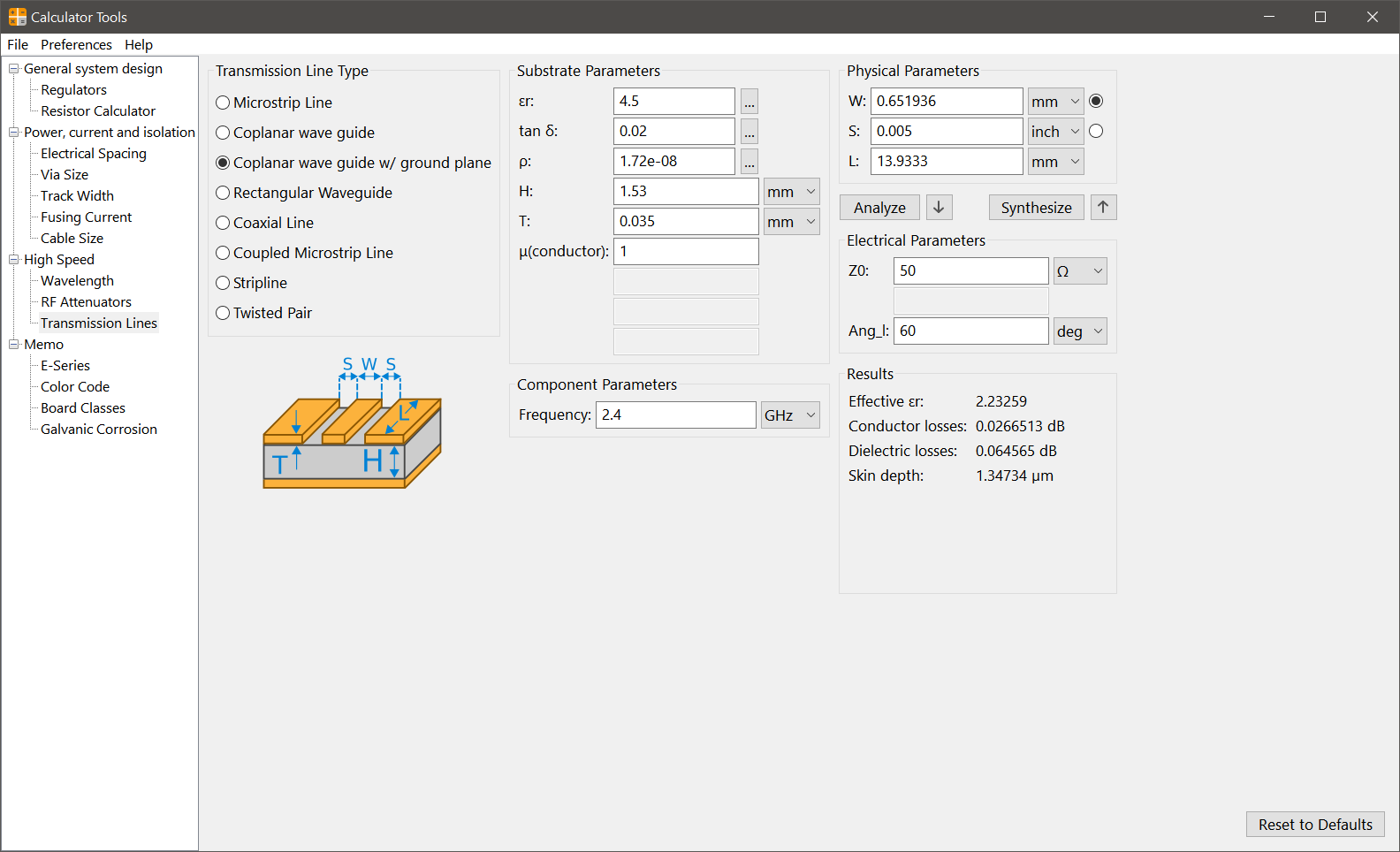

Initially, my plan was to simply use impedance matching calculations to create a coplanar wave guide with ground plane with a calculated 50 ohm characteristic impedance at 2.4GHz and have that go directly to the antenna from the LNA_IN pin, where I would simply follow the manufacturer's advice for matching the cable to the antenna with a 6.8nH inductor/choke in this particular instance with the Walsin Tech Corp RFANT3216120A5T.

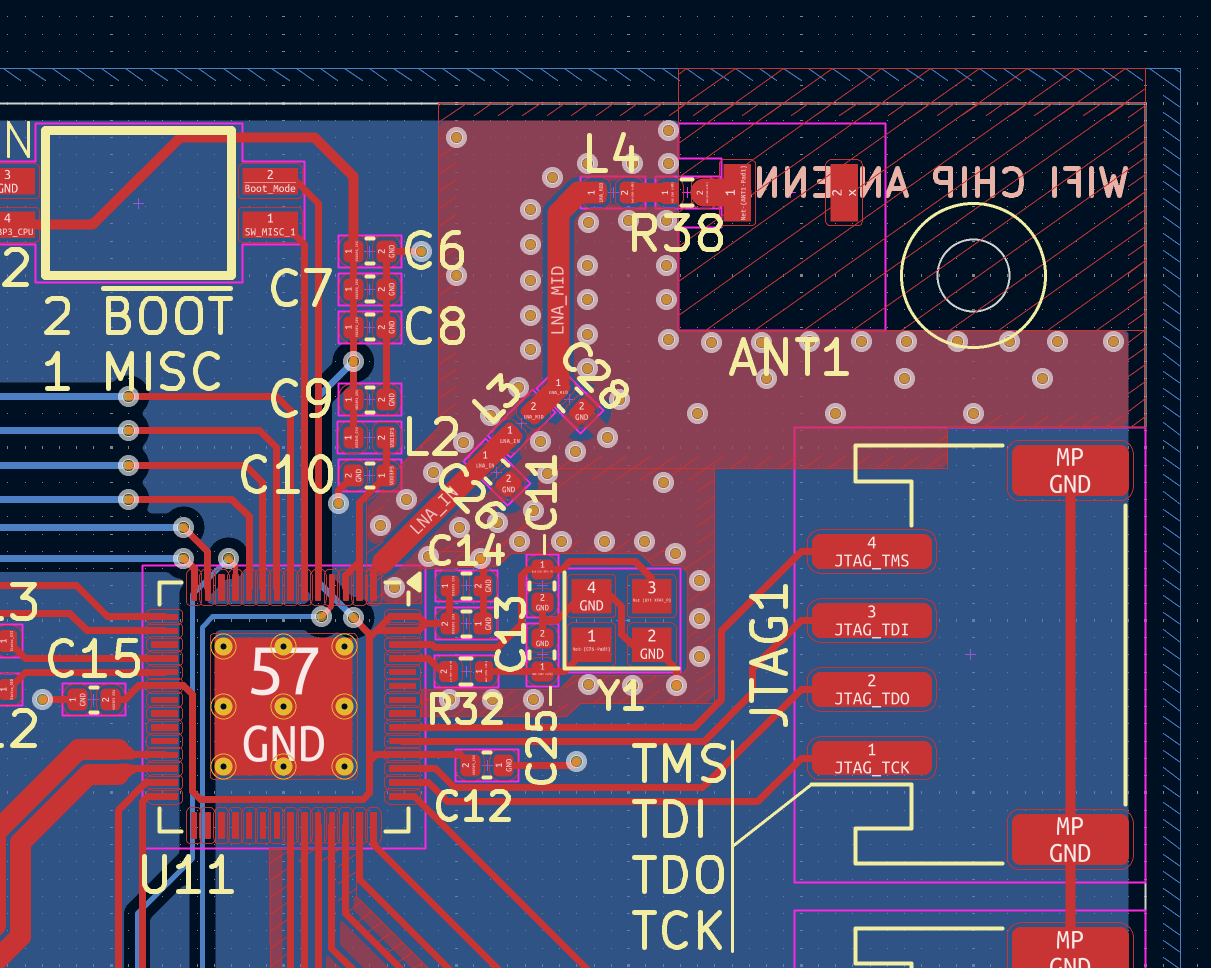

Lastly, I was hoping to know if my board image of the relevant section of my board layout looks like I am on the right track with regards to the coplanar wave guide with ground plane transmission line.
Relevant images are included below.

The big question I have there is, with what values? It is my understanding that these can only be acquired via tuning for each board so I wonder if having them without tuning would do more harm than having no CLC.
I suppose leaving the inductor as a 0HM resistor and leaving the capacitors as DNP (Do not place) would work for now, but it does make me fear the 0402 0 ohm resistor would change the impedance of the transmission line, making the calculated value incorrect and rendering the connectivity inoperable without tuning as opposed to simply nonoptimal, but operable.
I imagine I will probably eventually have to buy something like a LiteVNA 64, but I am hoping to have this work even if not optimally, immediately.

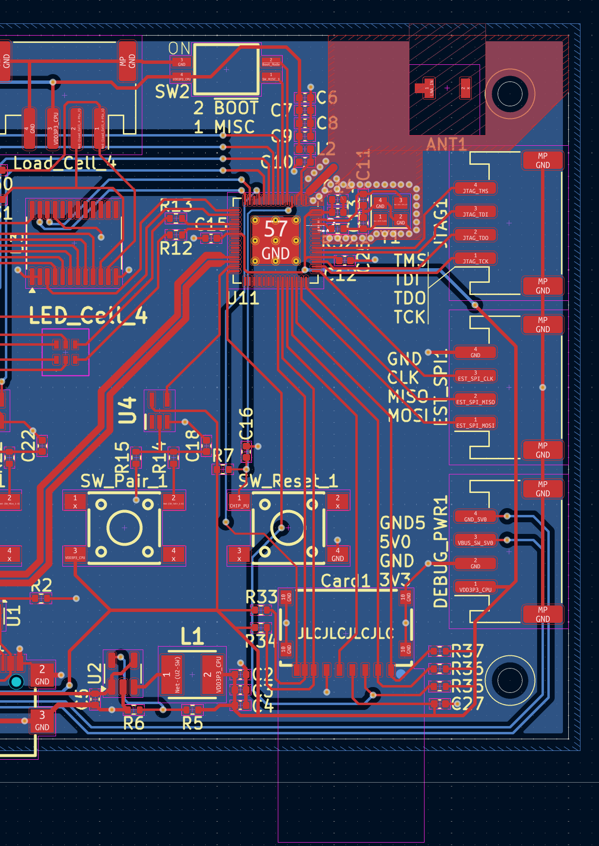

I've created a layout for the antenna for the ESP32-S3FN8 based on:
I've used 1 LQG15HS2N7B02D and 2 CC0402BRNPO9BN1R5 for the CLC and 1 LQG15HS6N8J02D and one 0 Ohm resistor for the Antenna RFANT3216120A5T (just following the datasheet).
All parts chosen were 0402(1005) apart from the antenna itself.
Values were just the middle of the range that Espressif recommended for the CLC, and exactly what the Antenna recommended for its connection to the feed line.
Hopefully I haven't missed anything key.
