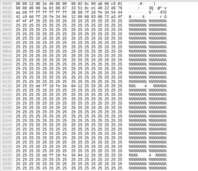

I'm not sure if I'm posting this in the right place, but I'm having a problem with the esp_now v2.0 program. My data is being truncated when my buffer is set to
CONFIG_ESPNOW_SEND_LEN=1024
I used the espnow example, and instead of using the
esp_fill_random
function to fill the buffer, I filled it with '%'.
In Wireshark, I see my buffer data truncated by 240 entries. I end up with 1014 entries in total.
It might be an option or parameter I've missed, but I'm stuck on this problem. :?:
Thank you for any help you can provide.
Sincerely, Marc.
PS : I am using idf.py 6.0
Bug esp now.jpg (151.74 KiB) Viewed 113 times

This structure will be used.
https://github.com/espressif/esp-idf/bl ... mple.h#L67
This represents the overall size of the structure.
The size of the payload within the structure is 1014 bytes.
// send_param->len = CONFIG_ESPNOW_SEND_LEN(1024)
// sizeof(example_espnow_data_t) = 10
esp_fill_random(buf->payload, send_param->len - sizeof(example_espnow_data_t));

Postby Marc059 » Sun Apr 05, 2026 4:21 am
I more or less understood that. ;)
How can you explain that Wireshark is telling me the data is truncated?
Thank you for the information.
Regards, Marc.

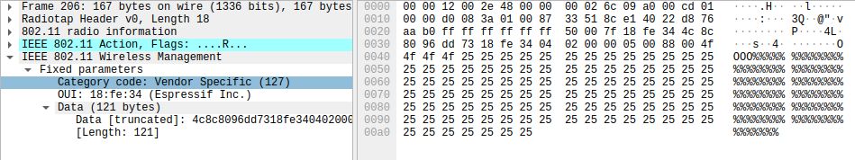

I'm wondering if the data sent by esp_now, specifically the "Data: IEEE80211_vendorspecific" parameter, complies with the standard, which may have changed?
Or perhaps the Wireshark program is reporting truncated data even though the "Data" parameter is 231, or even 121. :roll:
I don't want to overlook this parameter, but I'm having trouble understanding it. :idea:
Thank you for any help.
Sincerely, Marc.
Bug esp now 3.jpg (61.25 KiB) Viewed 89 times

Here is format of ESPNOW.
https://docs.espressif.com/projects/esp ... ame-format
Category Code: 0x7f
Organization Identifier: 0x18 0xfe 0x34
Random Value: 0x4c 0x8c 0x80 0x96
Vendor Specific Content:0xdd 0x73 0x18 0xfe 0x34 0x04 0x02 0x00 0x00 0x05 0x00 0x08 0x00 0x4f 0x4f 0x4f 0x4f 0x25 0x25 -----------------------
- Element ID:0xdd
- Length 0x73
- Organization Identifier:0x18 0xfe 0c34
- Type:0x04
- More data:0x0
- Version: 0x02
- Body:0x00 0x00 0x05 0x00 0x08 0x00 0x4f 0x4f 0x4f 0x4f 0x25 0x25 -----------------------
Maybe, IEEE 802.11 does not specify the format of the data following the organization identifier.
Therefore, Wireshark cannot accurately understand this part.

I completely agree. In fact, the first segmentation is done on 240 data points, then on 250 data points, not counting the 7 control data points.
I've adapted the PC program accordingly.
