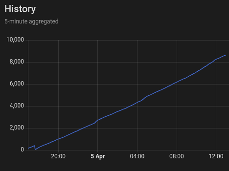

So these are the frame error statistics I got:
It seems every time I solder to it things change unpredictably. Not sure what is going on (temperature?). The frame errors I measured here were averages over multiple minutes, with about the same per minute. Measured over a longer period it is linear:
Unfortunately, this does not fix it, still getting a lot of frame errors.
- 0 with and without 10k ohm resistor connected from pin 21 to pin 43 (using 2cm wire on each leg). Using pin 43 as CLK
- 30% stock
- 0.5% with 10pf capacitor (between pin 21 and ground, directly on the mosfet and nearby capacitor)
- 11.5% with the extra 1.2k ohm resistor between pin 21 and 3v3.
- 18.5% when I soldered the 10pf capacitor back again, with small 0.5cm wires in between
- 62% when I soldered it back again, directly to the component)
- 45% back to stock
- 0 when I soldered the bridge from the mosfet on pin 21 with 10K resistor to pin 43.Using pin 43 as CLK. EDIT: for about 30 minutes this time. After that, a constant frame error rate of 1%
- last-error-log.log
- (174.74 KiB) Downloaded 19 times
