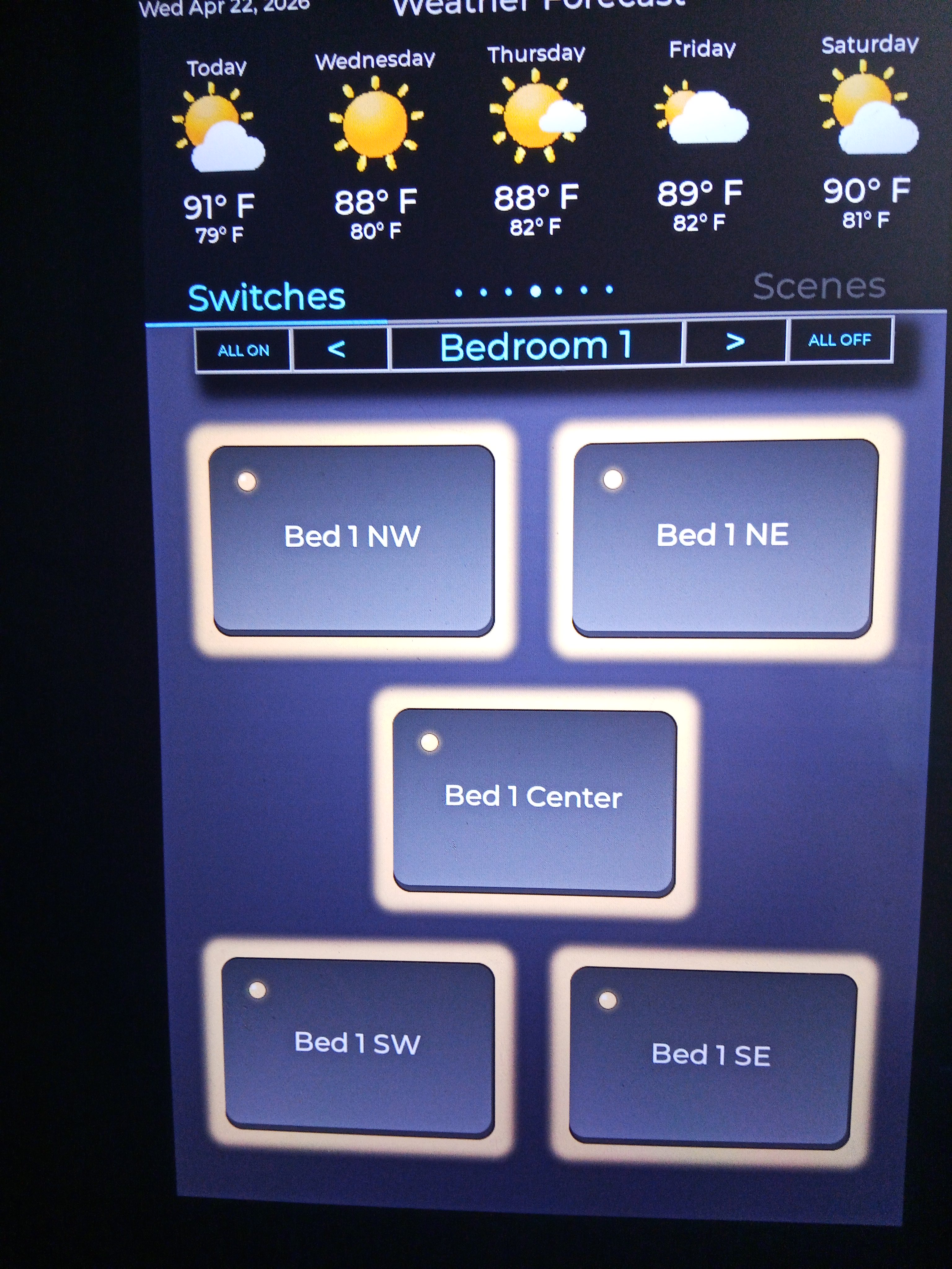

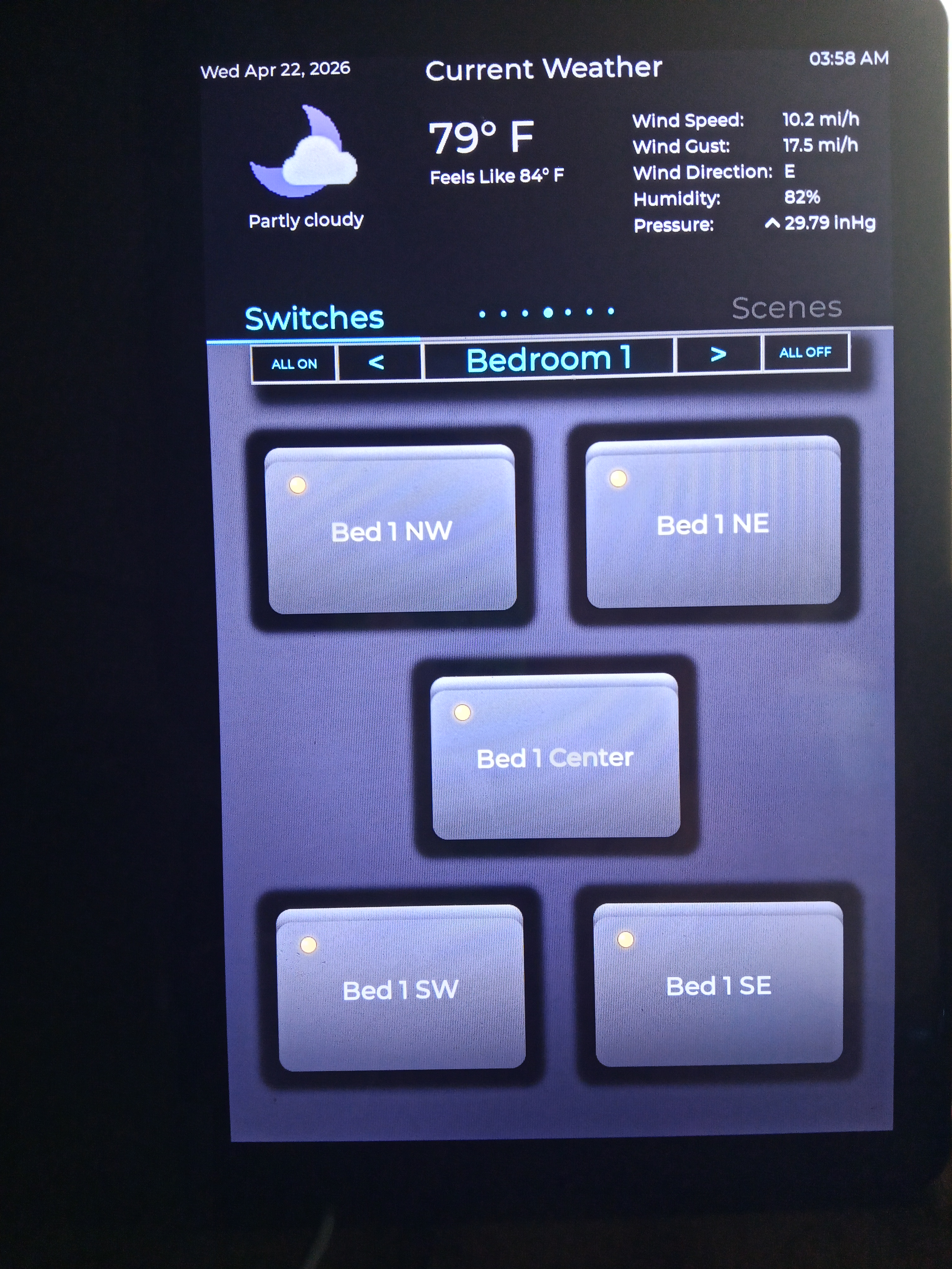

I got it to work, but had fun getting there. Need to flash the C6 as the firmware was to old and did not work with the current ESP-hosted component. Here is a couple of pictures of the current state of my Automation project.
Here my log till the app was up and running:

I (2442) jd9365: LCD ID: 93 65 04
I (2562) ESP32_P4_EV: Display initialized
E (2562) lcd_panel: esp_lcd_panel_swap_xy(50): swap_xy is not supported by this panel
W (2562) gsl3680: Unable to initialize the I2C address
I (2662) gsl3680: init gls3680
I (2662) gsl3680: gsl3680 connect
I (2662) gsl3680: gsl3680 read reg 0xf0 before is 0 0 0 0
I (2682) gsl3680: gsl3680 writing 0xf0 0x12
I (2702) gsl3680: gsl3680 read reg 0xf0 after is 12 34 56 0
I (2702) gsl3680: start init
I (2702) gsl3680: clear reg
I (2822) gsl3680: start load fw
I (3662) gsl3680: load fw success
I (3662) gsl3680: enter
I (3672) gsl_point_id: gsl_DataInit
I (3732) gsl3680: enter
I (3742) gsl_point_id: gsl_DataInit
I (3742) gsl3680: enter read_ram_fw
I (3772) gsl3680: gsl3680 startup_chip failed read 0xb0 = 5a,5a,5a,5a
I (3772) ESP32_P4_EV: Setting LCD backlight: 100%
I (3772) Disp:: Display splash
I (3772) Load_button_Tab:: Complete
I (3772) Loading Screen Tab:: Complete
I (4432) SCR_INT:: Complete
I (4572) Unlock:: Screen Unlocked

- 1000011280.jpg (3.85 MiB) Viewed 649 times
- 1000011282.jpg (1.95 MiB) Viewed 649 times
