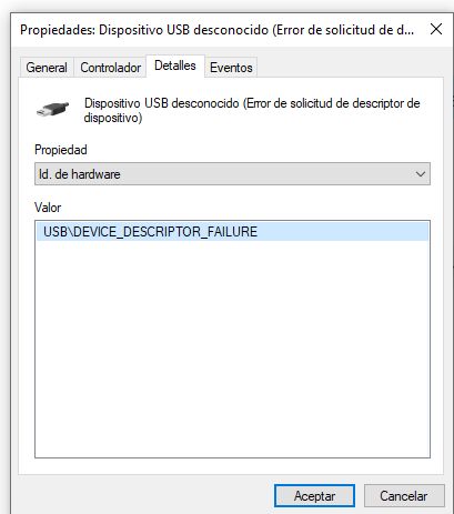

I'm having an issue with my ESP32-C6 module when connecting it to my Windows 10 PC. The device is not being recognized, and I keep getting the error message "USB Device Not Recognized." Here's a summary of my setup and the steps I've taken so far:

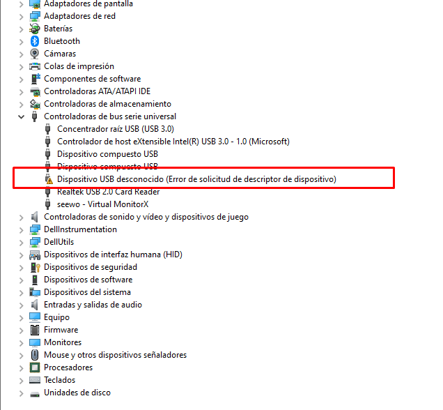

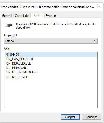

When I connect the ESP32-C6 to my PC using the USB port, it doesn't get recognized. Instead, I see an error in the Device Manager: "Unknown USB Device (Device Descriptor Request Failed)."

Checked the Device Manager for any warning symbols or errors under "Universal Serial Bus controllers."

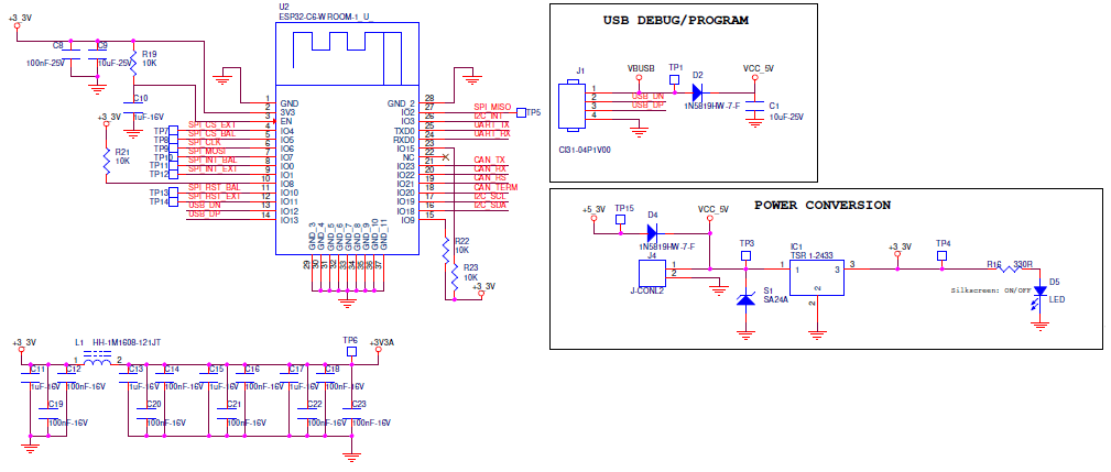

We use ESP32-C6-WROOM-1
We produced 10 boards, seven out of ten are recognized properly by the PC as COM port. The other three are not. So D+ and D- are not swapped.
However, those three faulty boards can be flashed by UART, and the rest of peripherals (WIFI, SPI,..) works properly.
It seems that the USB peripheral is damaged or not properly configured.

Possibly. Do you have a schematic you can share? Could be that you didn't implement USB properly.

Yes, I can provide you with a schematic:
Posts: 10617
Re: ESP32-C6 not recognised
Postby Sprite » Sat May 25, 2024 1:22 am
You're running IC1 awfully close to its limits... it has a minimum input voltage of 4.75V, and with the 0.2 to 0.3V dropout over the Schottky, you're getting in that range. Might be worth feeding in a power supply that is known to be high enough into it and seeing if your problems go away.
Aside from that, might be that the modules are caught in a reset loop. Can you wire GPIO0 low and then plug it in, see if Windows detects the chip OK then?
