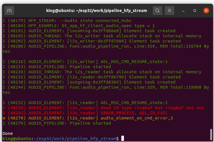

开发板ESP32-LyraT-Mini_V1.2运行经典蓝牙 HFP 例程pipeline_hfp_stream异常,没有声音输出

I (48178) HFP_STREAM: APP HFP event: AUDIO_STATE_EVT
I (48179) HFP_STREAM: --Audio state connected_msbc
I (48184) HFP_EXAMPLE: bt_app_hf_client_audio_open type = 1
I (48191) AUDIO_ELEMENT: [incoming-0x3ffd86e0] Element task created
I (48195) AUDIO_THREAD: The i2s_writer task allocate stack on internal memory
I (48202) AUDIO_ELEMENT: [i2s_writer-0x3ffd7604] Element task created
I (48208) AUDIO_PIPELINE: Func:audio_pipeline_run, Line:359, MEM Total:126764 Bytes
I (48216) AUDIO_ELEMENT: [i2s_writer] AEL_MSG_CMD_RESUME,state:1
I (48223) AUDIO_PIPELINE: Pipeline started
I (48226) AUDIO_THREAD: The i2s_reader task allocate stack on internal memory
I (48232) AUDIO_ELEMENT: [i2s_reader-0x3ffd6798] Element task created
I (48238) AUDIO_ELEMENT: [outgoing-0x3ffd8384] Element task created
I (48244) AUDIO_PIPELINE: Func:audio_pipeline_run, Line:359, MEM Total:118960 Bytes
I (48252) AUDIO_ELEMENT: [i2s_reader] AEL_MSG_CMD_RESUME,state:1
E (48258) AUDIO_ELEMENT: [i2s_reader] Read IO type ringbuf but ringbuf not set
E (48265) AUDIO_ELEMENT: [i2s_reader] ERROR_PROCESS, AEL_IO_FAIL
W (48270) AUDIO_ELEMENT: [i2s_reader] audio_element_on_cmd_error,3
I (48279) AUDIO_PIPELINE: Pipeline started
日志输出如上,蓝牙连接手机通话没有声音输出,输入。问问各位大神是啥问题。
