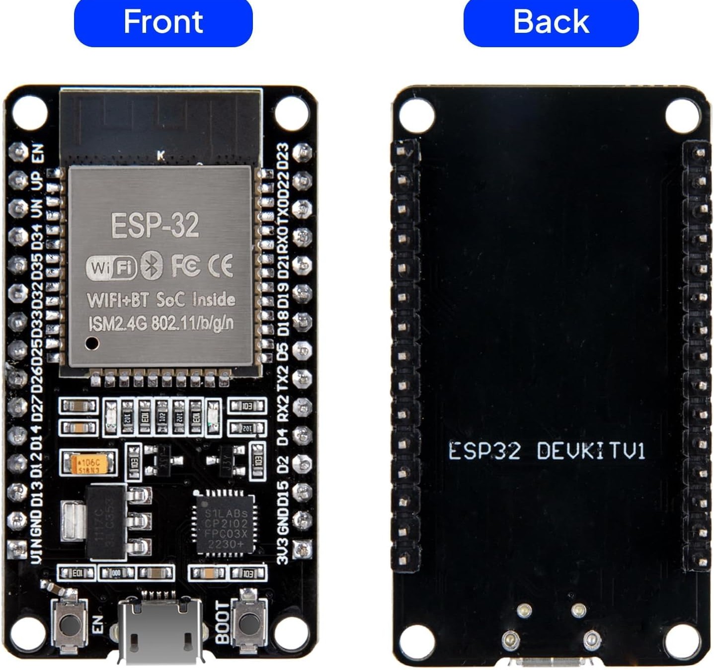

What hardware (devkit type, ...) do you have?
You might need to force the ESP32 into download mode the first time. If your board has the buttons, try (when it's plugged in) holding the BOOT button, pressing and releasing the RESET button, then releasing the BOOT button. That should give you a serial port for flashing, regardless of what state the ESP32 board was in before. (Note that normally you wouldn't have to do that, you can just reprogram the board without pressing anything)
Alternatively, if you're using the original ESP32 (no -C3, -S3 or anything), you might need to install a driver for whatever USB-to-serial chip is on the board in order for the serial port to show up.

no joy. holding the boot button and the EN button press didn't get me a port.
i do remember in the reviews for the boards i got alot of complaining about efuses being set in defaults for security and needing to encrypt the sketch or do something about an efuse. the reviews were not exactly clear on it but it was one of the selling points of being able to lock the board so that not just anyone could mess with it. however i get the feeling to fiddle with the efuses i need a serial interface. i mention this cause it might trigger a thought or my assumptions could be wrong and it is a efuse causing the current issue. experts would know better then me so put it out there so they are aware and see what comes.
i have never really installed extra "open drivers" (i hardly understand how to navigate github and i know i am definitely going to need to learn more there for my coming projects. that said i have no idea what drivers would be needed where to find them or how to install them. attached is one of the only 2 files of documentation i got with the board and i had to pull them from the selling page. one is the pin out and the other is attached. it provides all the information that could be gathered if i photographed it but perfectly crisp and in focus.
also thank you for all your help so far sprite
edit because i didn't notice it till i tryed repeating the process over and over thinking maybe i did something wrong in the process. pushing and holding boot then hitting the en button does "something" on the computer i can get the cursor to show it computer is trying to do something on command by holding boot and pressing en.

That's a CP2102 USB-to-UART chip... could try this and see if it works then.

"bittermen you are in the green and ready to go" or maybe in the blue would be better considering the pin 2 built in is blue.
sprite i would like to take this opportunity to say thank you so very much i have everything all figured out now i was able to upload my first sketch for an esp32 successfully thanks to your help.
