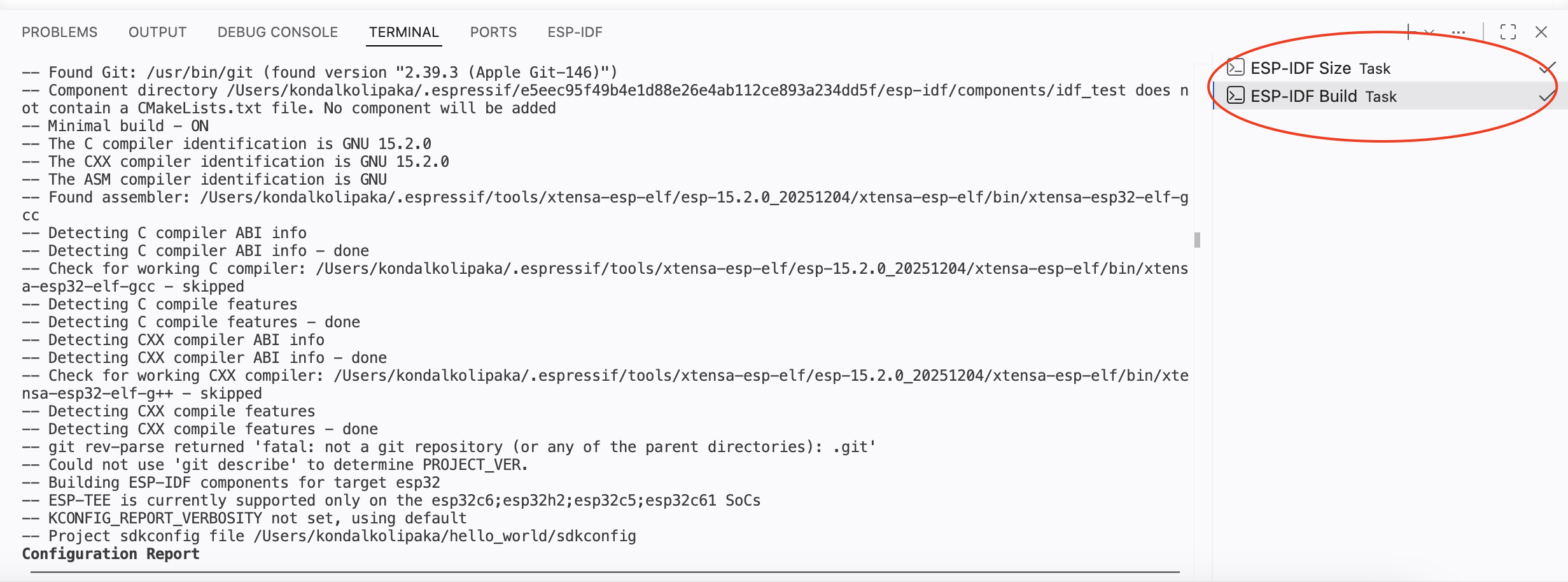

As this happens because it was switching from the build task to the size task terminal internally.
VSCode has inbuilt support for switching terminals.
Windows / Linux: Press Ctrl + PageUp (previous) or Ctrl + PageDown (next).
macOS: Press Cmd + Shift + ] (previous) or Cmd + Shift + [ (next)
Screenshot 2026-06-29 at 11.29.26 AM.png (279.97 KiB) Viewed 27 times
