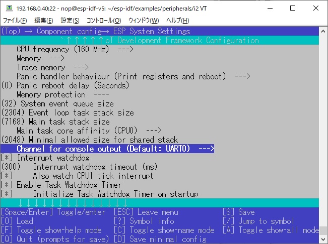

Re: error in nvsconsole exemple on esp32-c6
Here is.
- esp_system_settings.jpg (119.34 KiB) Viewed 44 times

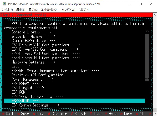

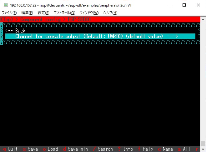

As of ESP-IDF V6, this item has been moved to Component config > ESP-STDOUT.I have same problem under linux mint with the version 6.02
- ESP-STDOUT-1.jpg (125.53 KiB) Viewed 23 times
- ESP-STDOUT.jpg (71.84 KiB) Viewed 28 times
