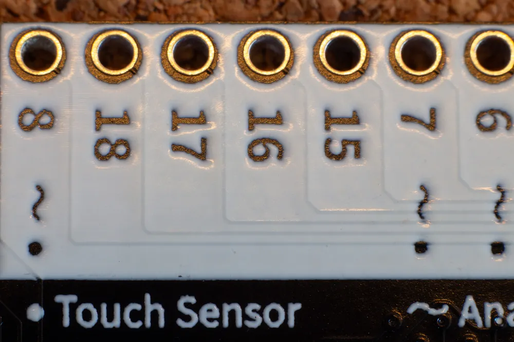

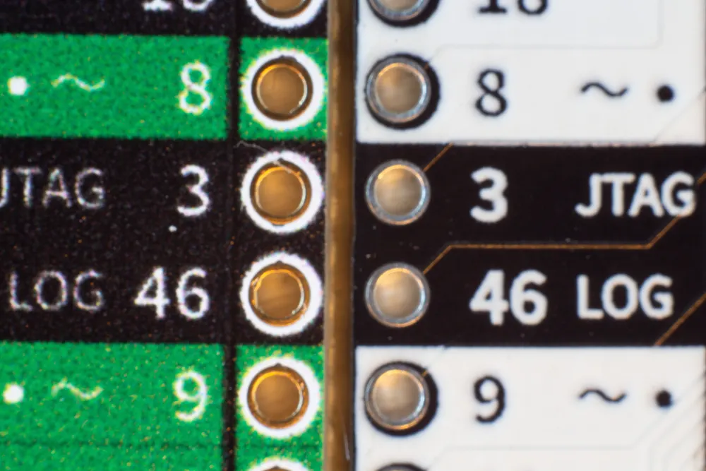

Both PCBway and JLCPCB allow coloured silkscreen. It is not multiple layers of colour but actually more like an inkjet printer.
https://jlcpcb.com/news/multi-color-silkscreen-pcb
https://www.pcbway.com/blog/News/Unlock ... 9d559.html
Below is the JLC pcb colour service; and normal black soldermask with white silkscreen. Colour comes with some downsides:
- White outline around copper areas (there is a base layer which is white)
- Normal silkscreen looks sharper; is more readable and less 'dotted' surfaces are nicely filled.
- Colorful silk screen needs bigger or bolder text to have the same readability.
- For normal silkscreen: make sure that inverted areas need extreme bold text to make it readable and visually match up with the non-inverted areas)
