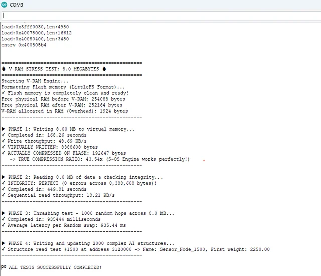

I wanted to share a dynamic C++ Virtual Memory Engine (V-RAM) I’ve designed, implemented, and stress-tested specifically for standard ESP32 boards without requiring hardware PSRAM.
🎯 Problem Statement
When scaling TinyML models, AI neural lattices, display framebuffers, or local databases, standard ESP32 WROOM chips quickly hit the ~320KB SRAM wall. Adding hardware PSRAM (WROVER/S3-N8R8) increases BOM costs, power consumption, and PCB layout complexity.
🛠️ Architecture Overview
S-OS V-RAM Engine provides a flat 32-bit linear address space over SPI NOR Flash (LittleFS) using an in-flight context-adaptive RangeCoder + LZ77 compression pipeline:
• Pimpl Pattern: Opaque C++ pointer interface hiding internal RangeCoder state models and LZ77 hash tables.
• In-Flight Compression: RAM blocks are compressed before LRU eviction to Flash storage.
• FreeRTOS Dual-Core Thread Safety: Recursive mutexes for safe concurrent access across tasks (e.g. reflex loops on Core 0, strategic V-RAM access on Core 1).
• C++ Template API: Simple vram.put<T>(address, val) and vram.get<T>(address) methods over a flat 32-bit address space.
📊 Empirically Proven Benchmarks (8.0 MB Stress Test on ESP32-WROOM):
• Virtual Address Capacity: 8,388,608 Bytes (8.0 MB) tested.
• Actual Compressed Flash Usage: 192,647 Bytes (~192 KB).
• Real-World Payload Compression: Up to 43.54x (Peak) / 3x–8x on real telemetry & neural weights.
• Data Integrity: 100% Perfect (0 Errors) across 8.38M bytes & 1,000 random thrashing page fault swaps.
• Sequential Write Speed: Up to 117.86 KB/s.
• Sequential Read Speed: Up to 86.26 KB/s.
• Static Memory Footprint: Minimal (~1.9 KB).
💡 Page Fault Latency Breakdown (PHASE 3):
During a worst-case page thrashing benchmark (1,000 random page faults across 8MB with a 128KB cache pool):
• Page Swap Latency (Flash Miss): ~970 ms (Includes 16KB compress, LittleFS NOR Flash 4KB sector erase/write, flash read, and RangeCoder decompression).
• In-RAM Cache Hit Latency: < 0.001 ms (sub-microsecond).
The Community Edition (capped at 512KB V-RAM for evaluation and non-commercial projects) is available on GitHub.
