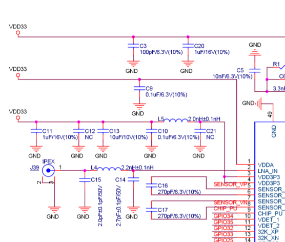

Hi Reza, the schematic I had posted before was from an early version of ESP-WROOM-32U. The datasheet http://espressif.com/sites/default/file ... eet_en.pdf has just been published and you can check the final schematic on page 15
[img]
ESP-WROOM-32U Pi filter.png (81.33 KiB) Viewed 16437 times
[/img]
I hope this helps.
WiFive
Posts: 3529
Re: What matching components should be used for the 5x5 QFN package?
Postby WiFive » Tue Nov 28, 2017 10:46 am
So wroom32 is switching from tapped capacitor matching to pi matching?
Franco
Posts: 110
Joined: Thu Dec 10, 2015 1:11 pm

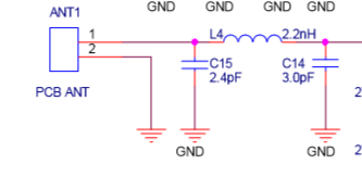

Postby Franco » Tue Nov 28, 2017 10:55 am
I checked the ESP-WROOM-32 (with PCB antenna) and the schematics on page 17 shows a similar Pi matching circuit.
WiFive
Posts: 3529
Postby WiFive » Tue Nov 28, 2017 12:12 pm
WROOM-32 has tapped capacitor matching circuit, so does WROVER.
WROOM-32D/U has pi circuit.
Interested to know reasons and effects.
