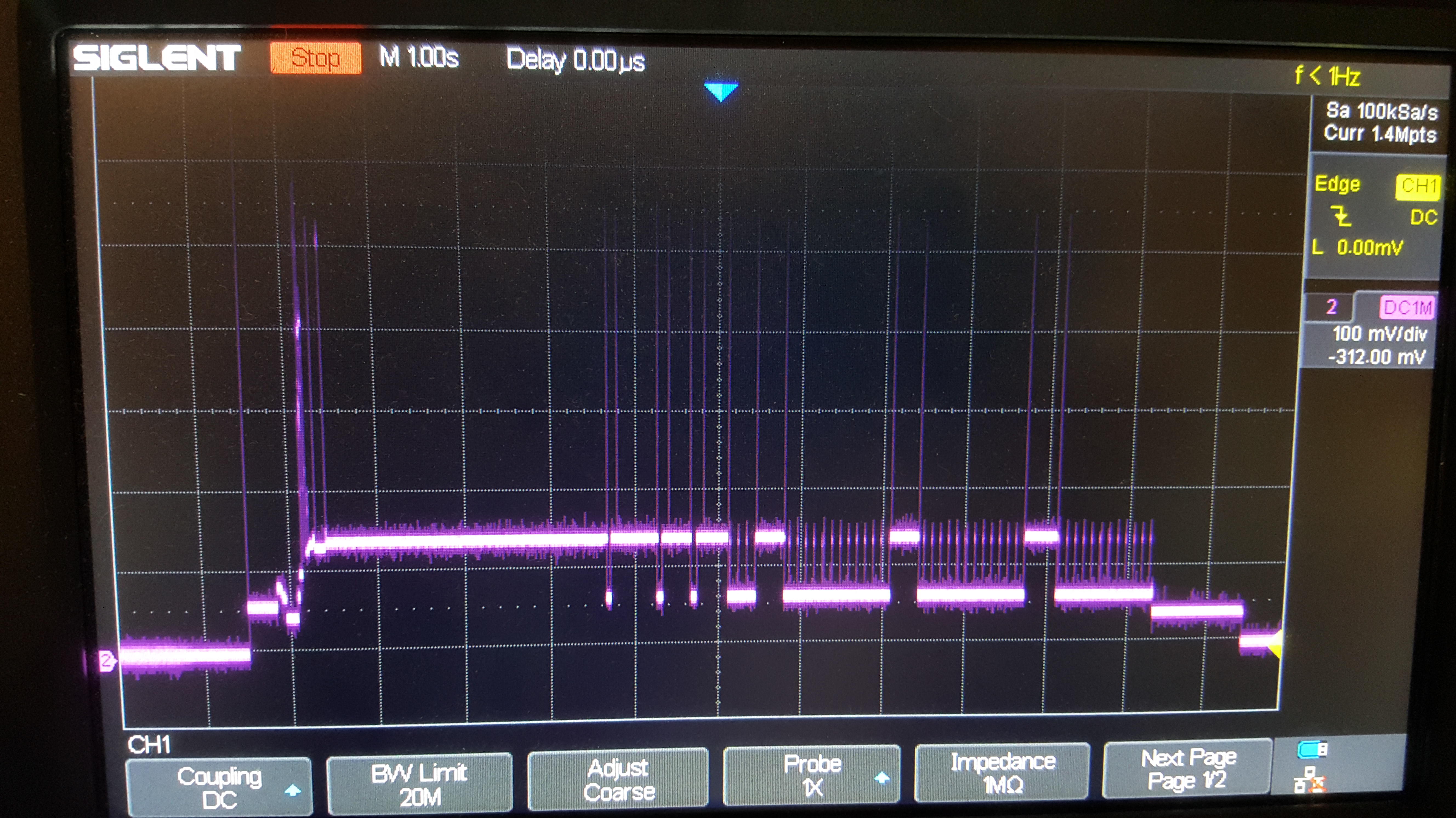

Does anyone known why esp32 wifi lib enables modem sleep only after some time the connection to ap is made?
I am observing about 4-5s delay before modem begins to be turned off - see attached image - 1 sec per horizontal division, 100mA per vertical division.
Is there any way to make the modem sleep to kick in sooner?

This was (is) a feature which made its way from the ESP8266, which had cases of packet loss in modem sleep mode early on, which caused some cases of lost DHCP replies, which in turn caused longer times until IP was obtained. On the ESP32 it seems to be unnecessary. We do have a work in progress branch which removes this extra delay, it should be available in master along with the upcoming frequency switching implementation.

Could you please quantify "long"? Once the station is connected to the AP, there shouldn't be much of a delay.

By long I mean 3+ seconds. See attached image - more than 3 secs (1second per horizontal division)
This is compiled with current esp32 sdk head (1c3dd23fe0c547c5cdcd6a01c111145c572dab91)
Attached sdkconfig as used in app.
