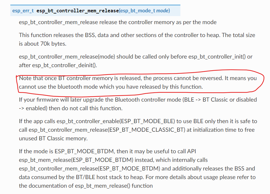

Hi All,
We are developing an application using esp-mdf. In application we need BT only during provisioning, once it is done, we don't need BT and we would like to free up all the memory used by BT as we are running out of heap memory.
It seems BT is allocated 56K memory during compile time.
file=esp-idf/components/bt/bt.c
343 /* the mode column will be modified by release function to indicate the available region */
 344 static btdm_dram_available_region_t btdm_dram_available_region[] = {
 345     //following is .data
 346     {ESP_BT_MODE_BTDM,          SOC_MEM_BT_DATA_START,      SOC_MEM_BT_DATA_END         },
 347     //following is memory which HW will use
 348     {ESP_BT_MODE_BTDM,          SOC_MEM_BT_EM_BTDM0_START,  SOC_MEM_BT_EM_BTDM0_END     },
 349     {ESP_BT_MODE_BLE,           SOC_MEM_BT_EM_BLE_START,    SOC_MEM_BT_EM_BLE_END      },
 350     {ESP_BT_MODE_BTDM,          SOC_MEM_BT_EM_BTDM1_START,  SOC_MEM_BT_EM_BTDM1_END     },
 351     {ESP_BT_MODE_CLASSIC_BT,    SOC_MEM_BT_EM_BREDR_START,  SOC_MEM_BT_EM_BREDR_REAL_END},
 352     //following is .bss
 353     {ESP_BT_MODE_BTDM,          SOC_MEM_BT_BSS_START,       SOC_MEM_BT_BSS_END          },
 354     {ESP_BT_MODE_BTDM,          SOC_MEM_BT_MISC_START,      SOC_MEM_BT_MISC_END         },
 355 };
Calling the following API does free up the dram regions but one chunk of memory (30k) is never freed.
esp_bt_mem_release(ESP_BT_MODE_BTDM);
Specifically, the following chunk is not freed.
And the reason is if condition at Line#1038:
Code: Untitled.c Select all

For " ESP_BT_MODE_CLASSIC_BT ", the above piece of code, hits "//skip the share mode, idle mode and another mode".
Is there a way to free up that 30k chunk?
0x3ffb2730 - 0x3ffb6388 (???) = 3c58
As per the documentation, we should get about 70k memory but we are not able to get it.
Are we missing anything here? Is there a way to get all the BT memory?
BR.

Classic Bluetooth controller memory can be freed, but this means you can't use classic Bluetooth mode.
屏幕截图 2021-06-22 114320.png (140.51 KiB) Viewed 9624 times
