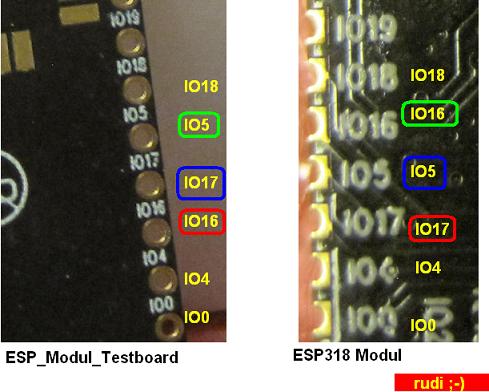

thank you for the ESP32 gift!
i have get the ESP_Module_Testboard and the ESP318 Modul.
On the ESP318 Modul there are pin named like this
IO16
IO5
IO17
and on the ESP_Module_Testboard ( Breakout)
IO5
IO17
IO16
picture:
question:
is the ESP_Module_Testboard right named to the RTOS SDK 1.0for use the ESP318 Modul?
( have not route the pins just in time )
have/can we (use) the ESP_Module_Testboard for the ESP32 release too,
are this perhabs the release pin names on the ESP_Module_Testboard and
we must consider this in beta phase with the ESP318 Module and RTOS SDK 1.0
example:
ESP_Module_Testboard with ESP318
Pin names on ESP_Module_Testboard then:
IO16
IO5
IO17
ESP_Module_Testboard with Release ESP32(later)
Pin manes on ESP_Module_Testboard like they named:
IO5
IO17
IO16
Thank you for your help!
Hope the question is clear formular.

Dear Rudi,
There is something wrong with silkscreen of the first version of ESP_Module.
P.S. The second version of ESP_Module has already fixed this error.
The actual pin order of ESP_Module is just as shown in the ESP_Module_Testboard which is GPIO5, GPIO17, GPIO16.
Please neglect the silkscreen of these 3 pins in the ESP_Module.
Any more questions, please let us know.
Thanks.
